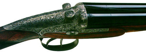

In 1881, a gunsmith from Saint Etienne, Régis Darne, patented a new basically different type of shotgun. It has a fixed barrel and a rotating breech system : the C model. By pushing the top lever, the breech block rotates 90 degrees on the right and gives access to the chambers (it doesn’t have ejectors). C models were available in 3 grades : C2 to C4.
In 1897, appeared the first famous sliding breech system that we know today. Improved years after years, it was a real commercial success and Darne shotguns won a lot of golden awards in gun shows and shooting competitions.

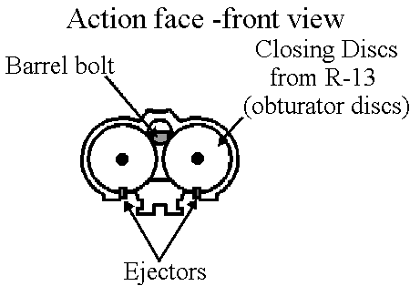

Typical Darne action face:

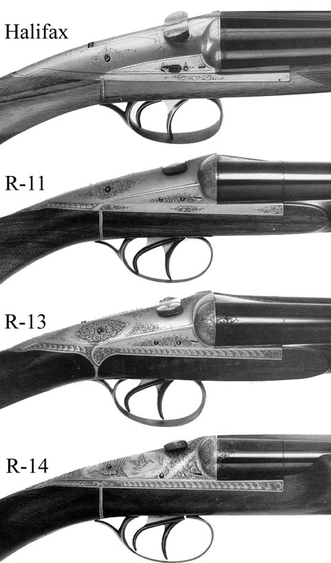

B&W Pictures of Halifax, R-11, R-13, R-14 (76k)

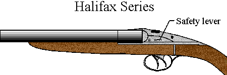

Halifax Series:
Three grades : type 3 (3 PM) to type 5 (5 PM)
Upper barrel bolt from type 4
Proof : X for type 3, XX for type 4 and 5
Safety lever
Wood in one piece one certain models (forearm+stock) depending on the year of fabrication
Darne Halifax

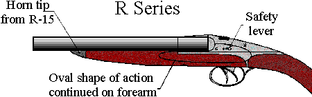

The R Series:
Eight grades : R10 to R17 (no PM to 7 PM)
All the guns of this series have the upper barrel bolt
Special closing disks are mounted on the breech from R13
Horn piece in the front of the forearm from R15
Proof : XX for R10 to R12, XXX for R13 to R17
Opening in two steps on all models (first unlock then slide)
Safety lever
Darne R series

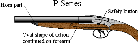

The P Series:
One Grade : P17 (7 PM)
Upper barrel bolt
Closing discs
Proof : XXX
Opening in one step (unlock and slide in one movement)
Safety button
Darne P series

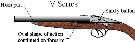

The V Series:
Four grades : V19 to V22 (9 PM to 12 PM)
articulated triggers (firing pressure adjustable by shooter)
Upper barrel bolt
Closing discs
Opening in one step
Proof : XXX for V19 to V21, XXXX for V22
Darne P series

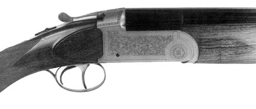

The S series (Over/Under):
Darne also produced few O/U : type S1 (1 PM) to type S3 (3 PM)
Darne S series
