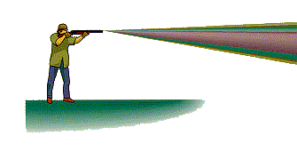

Chokes
Image compliments of: Briley Manufacturing
The "choke" of a shotgun is a small constriction applied near the muzzle of the barrel that effectively changes the patterning characteristics of the shot as it passes through. The constriction is the difference between the tightest inside diameter measurement of the area of choke, and the actual bore diameter. For example a typical 12 gauge barrel has an inside diameter of .729" the chokes for this bore size would run from cylinder at .729" to Full at .689".
