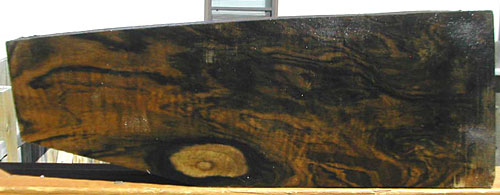

Figure in the wood makes for some eye-candy!

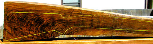

First and foremost a blank MUST POSSESS proper grain flow or layout for a gunstock. In its most perfect form, the grain must run from the toe of the stock, arching up through the buttstock, to straighten out through the grip or move up through the grip, then the grain must run true to the forend of the stock.

Fourth, is usually the only criteria guiding a customer, it’s sad to say. That is figure. What I am calling figure is the generally BLACK lines, or in it’s best form, marbling found in this type of walnut. All the figure in the World will not make a stockblank for a fine gun. This is why I have placed it low on the priority list. Without the other ingredients, in some degree, you only have a piece of wood cut in a trapezoidal shape. Not a gunstock!
