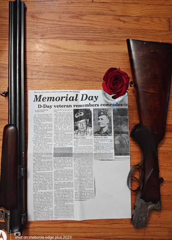

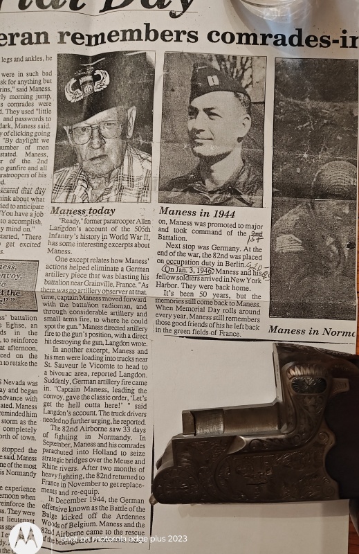

Major Maness just may not have had an heirs or assigns and that was the reason all his War Trophy stuff was liquidated?? No, he did have @ least one daughter & she sold the whole lot in 2014.....
Maness joined was somehow associated with the US Army in 1936-1937. Then he rejoined in 1941 and earned his keep starting in Oudja, Afrika in 1943. Later he was @ Normandy, then Holland and on to the Battle of the Bulge where in December 1944, he was promoted to Major. His last stint was as an occupation force in Berlin.
Posts: 12,111
Likes: 381
ellenbr Offline OP
Posts: 12,111
Likes: 381
Unfortunately, his Paratrooper Jump Jacket, Jump Boots, Parka, BYF-43 P-38 w/ original holster, extra mag, 7mm German rifle, etc. were all parted a couple dealers back in time.
