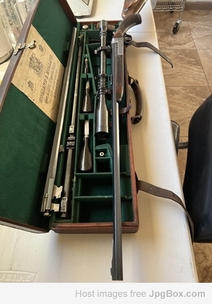

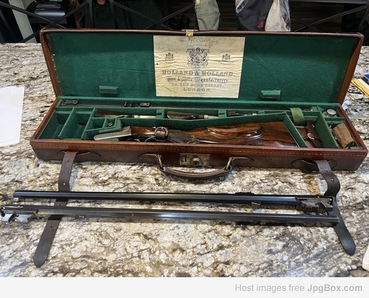

Than you guys. I ordered some brass and bullets. Will work on reloading next.
I would still ie to get vintage box to go in the case.
URL=https://www.jpgbox.com/page/70709_600x400/][Linked Image from jpgbox.com][/URL]
URL=https://www.jpgbox.com/page/70710_600x400/][Linked Image from jpgbox.com][/URL]

Ghostrider,
Nice rifle and outfit. Is one of the spare barrels a shot barrel?
To fit the case you probably need a pre-1939 50 round box (no dividers, rounds boxed nose to tail like they used to box .22 rimfire).
The post war boxes with dividers and rounds all base up are a bit bigger.

Thank you for the information on the box.
Yes one barrel is a 410 converted from a 300 Rook barrel. Very well done.

Thanks, what calibre is the third barrel?
