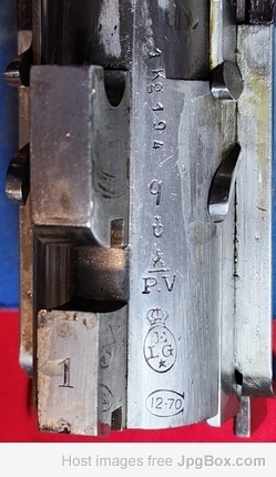

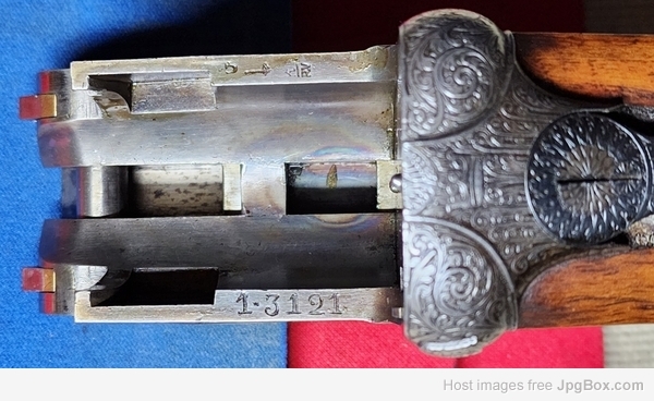

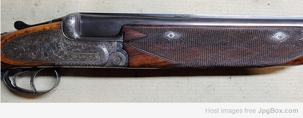

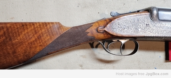

Acquired this Belgium built 12g SLE O/U from a local estate sale. Any information appreciated. No maker information on the gun. Appears to have a no.2 barrel, but not with the gun. Photos for identification.

Q would be 1938 proof date probably 1 of a pair, which seems to be a good sign of better quality. Any names on the gun? More pics?

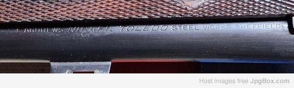

Interesting that it seems to have English tubes in a Belgian gun, the reversal of what often happens.

JNO. HY. ANDREW & CO. LTD. TOLEDO STEEL WORKS SHEFFIELD appears on high grade between the wars doubles of several Liege makers; including Verney-Carron, Jules Bury, Nicolas Lajot, L. Christophe & F. Thonon
http://www.littlegun.be/arme%20belge/artisans%20identifies%20t%20w/a%20thonon%20fernand%20gb.htm
It is unclear if the tubes were manufactured in Liege or England.

Ah, bar stock could have been delivered but like Krupp, etc. All steel makers filed a trademark & then licensed a local steel concern to make the bar stock

JNO. HY. ANDREW & CO. LTD. TOLEDO STEEL WORKS SHEFFIELD Barrels on a Belgian gun is a sign of high quality, they are first rate quality and costs a bit more than Krupp in the same period.
A great looking quality gun.
What is the barrel length and overall weight?

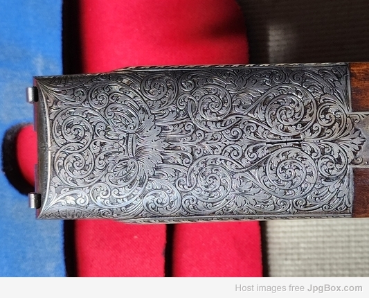

Engraving almost looks Austrian

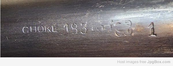

Barrel length: 27.5", total gun weight: 7# 3oz. Choked +0.710 U and +0.689 O.
From what I can see, hammers, ejector hammers, cocking dogs, all gold washed.

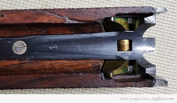

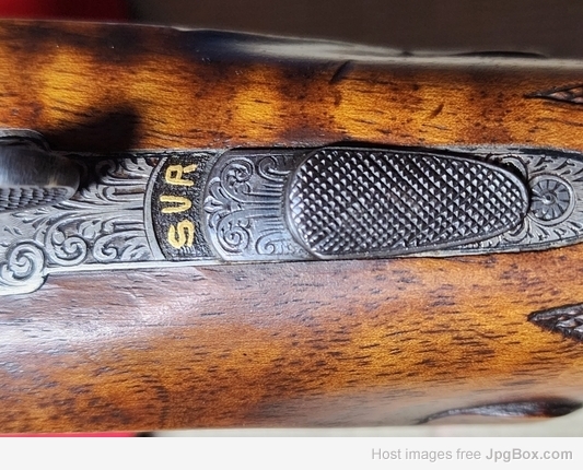

Photo of safety mark:
Forearm with ivory insert:
Ejector hammers:

Um, hum....... Sûr for Safe and an Anson Pushrod forend.

Really nice gun. Is there a reason you described it as an O/U?
