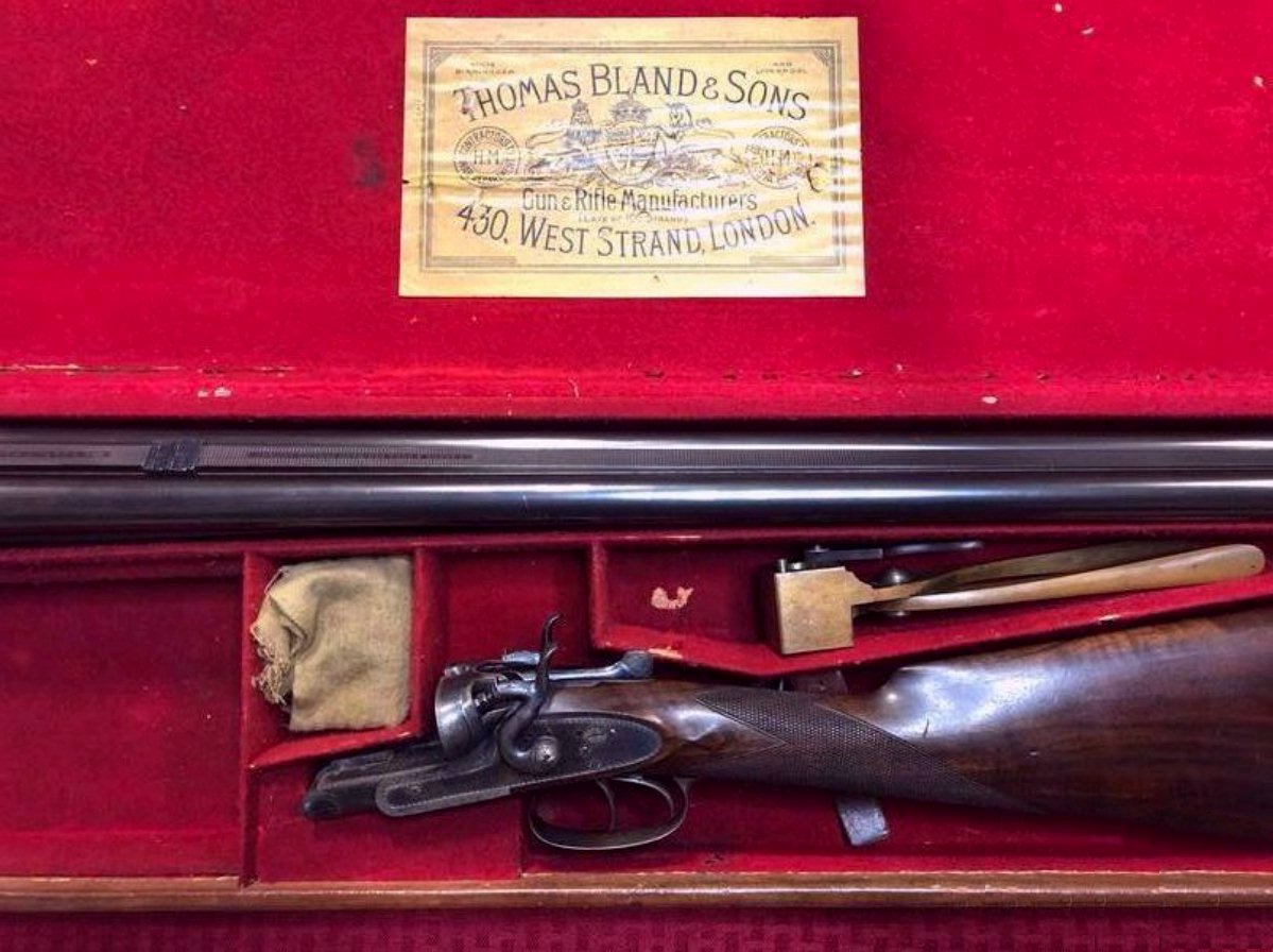

THOMAS BLAND & SONS - "EUOPLIA" - 12GA PARADOX GUN
Hello All,
I brought this over from another Forum because I'm so excited about the purchase that I wanted to share it here also.
I've been looking for a Paradox Gun for about 4 years. Several have escaped me because they were too pricey.

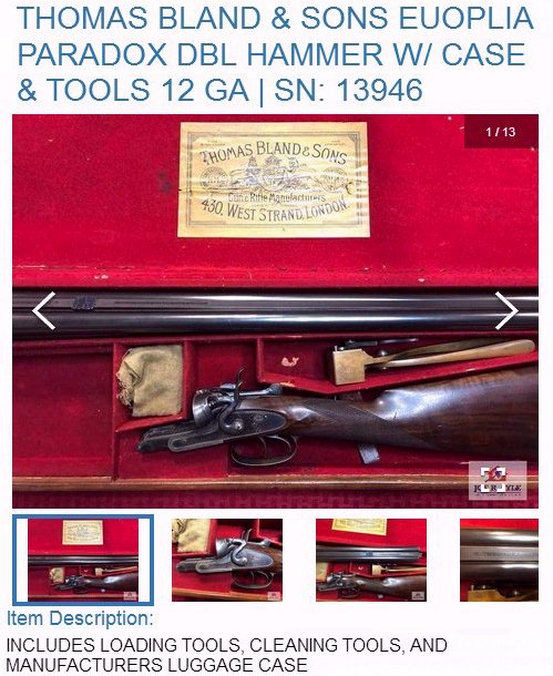

I took a real gamble on this Paradox Gun because the auction listing had a very skimpy description.
This picture below was the only information that was listed about the gun.
I didn't want to ask too many questions before bidding, because in the past it has resulted in the Auction House updating the listing which made it more desirable to all the auction watchers, and caused the price to shoot-up beyond my budget. So, I bit my tongue and took a gamble. The RED background photos are from the auction listing. The other photos are mine.

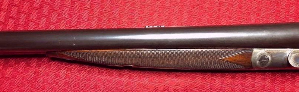

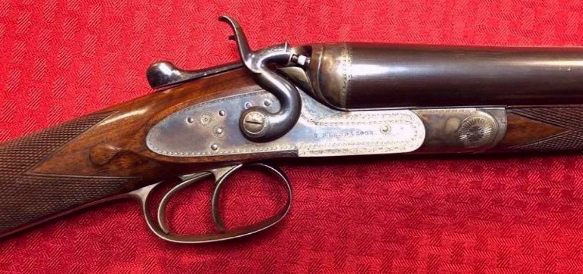

Well, the gamble paid off in spades. I received a absolute MINT condition Paradox Gun, Factory Cased with matching bullet mold, loading tools, and cleaning accessories. Its hard to believe this gun is 127 years old.

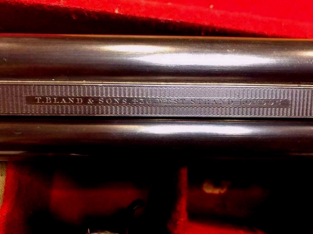

Here's the specs:
28" Barrels - 13-7/8" LOP - 7 lbs 6 oz - Rebounding Hammers - 2-Leaf Express Sight marked "50" & "100"
Rib is marked "The "EUROPLIA" Ball & Shot Gun" - "T. Bland & Sons 430 West Strand London"
Barrels marked "A&T" (Adams & Tate - maker) - Birmingham Proofed

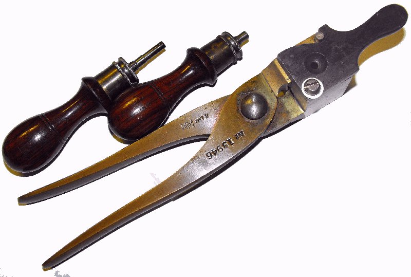

Matching Bullet Mold - Casts a Conical bullet - 790g RN & 730g HP
Misc. Tools, Powder/Shot Measures, Loading Tube/Rammer/Decapper, Capper, & Wad Punch
What's really amazing is the condition. All original finish in nearly 99% condition with full case-color remaining. Bores and chambers appear to be "un-fired". The only defect I could find was a small 1/16" chip off the tip of the toe of the horn butt-plate.
My only question is: the end of the cleaning rod handle has a leather washer pinned to its end. What is this for? ... and, does anyone know who Mr. Shields might have been?
As always, your comments are most welcome.

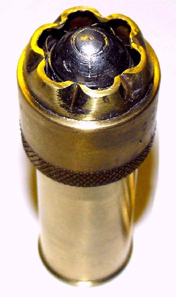

Hello all,

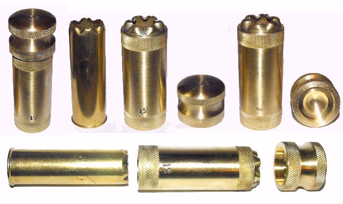

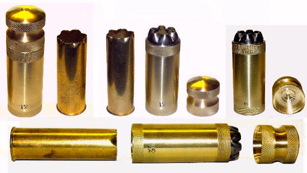

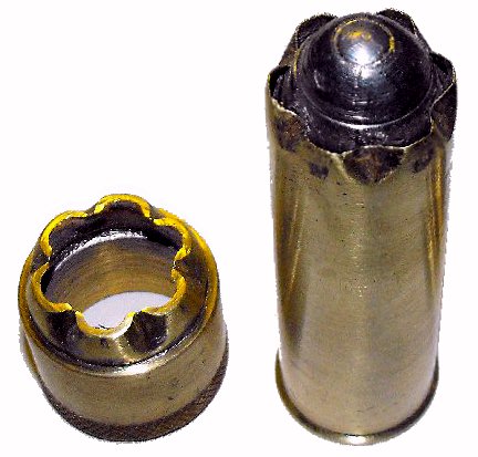

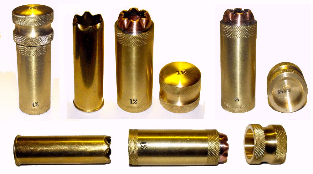

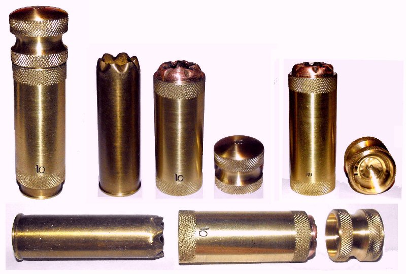

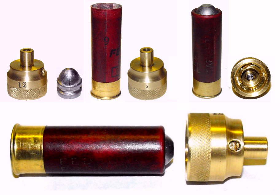

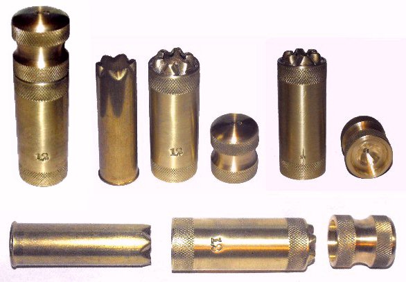

Well, I've loaded some ammo for the range test tomorrow. I used the existing loading tools.

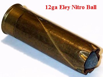

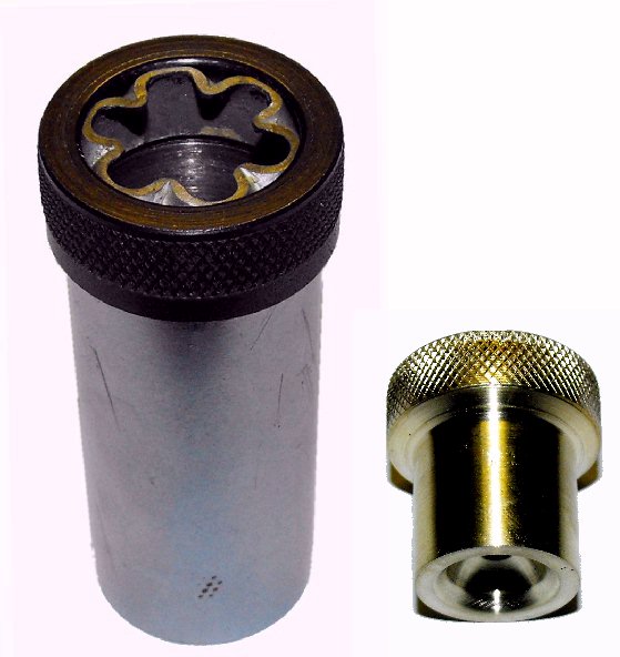

I saw an interesting crimping method that Eley used for their ball loadings, so I made a tool to replicate that crimping method. It worked great.
I opted to use a low pressure smokeless load so as not fowl up the rifle with black powder.
Tomorrow I should have some shooting test results.
UPDATE:

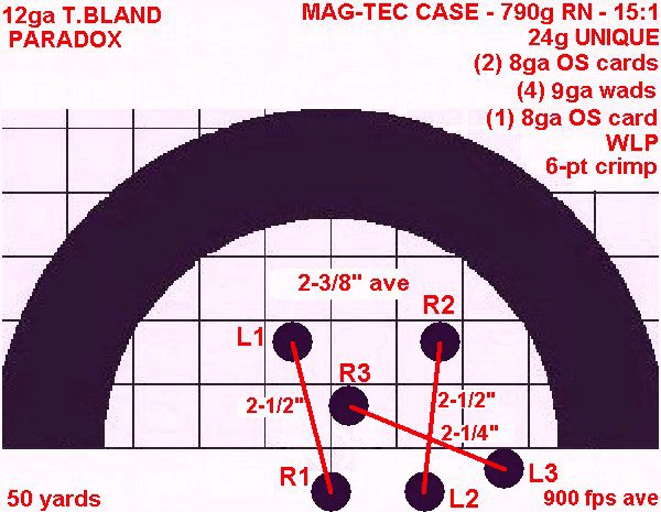

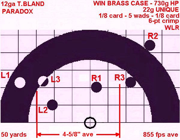

Here are the first range results. Not too impressive yet. But not a concern beause velocity for these should be 1000 fps to 1050 fps and and I'm at 855 fps. Increasing velocity should bring the shots together.

Buckstix wouldn't want to make another brass case crimper like that and sell it to me would you? lol

Hello Mike Harrell,
Thanks for the reply.

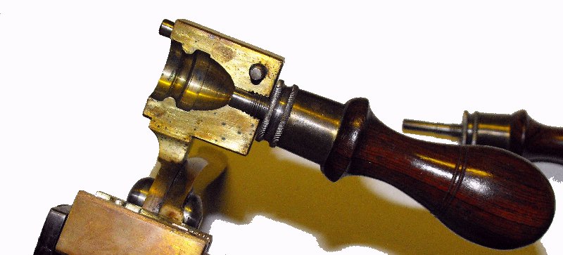

I would be making more of my crimping devices if I could find some of the MEC brass crimp starters. Unfortunately they are long discontinued by MEC. Now they are made of plastic. I've seen some of the brass inserts for sale on eBay, but they go for $25 - $35 each. If I ever find a source, I'll make some and offer them for sale.

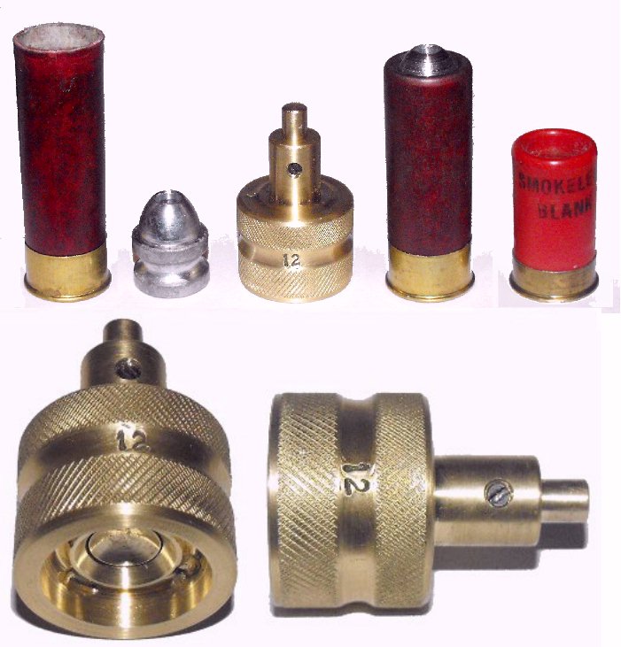

Here are pictures of the bullets from the mold.

By the way - For those of you that asked about me making them a PARADOX SHELL CRIMPER .... I bought a crimping star at the Gun Show and made another PARADOX CRIMPER.
$150 delivered - PM me.

I have a very similar gun, just a little less engraving and get 2.5 inch group of two shots using Brenneke slug loads.
Hello bavarianbrit
Here's the results from the last testing. I tested 5 different wad / card / bullet combinations. Groups measured 2-1/4" to 7" at 50 yards. Here's the best combination tested. Apparently this gun prefers a little harder bullet of 15:1 alloy, (BHN 11) and the heavier 790g Round Nose as compared to the 730g Hollow Point.
I'll be testing this load formula again with both HP and RN bullets to make sure the results are repeatable.

Very similar to what my three shooters grouped out at. They are an amazing tribute to handmade engineering btw mine cost me $450 around 1997.

Hello All,
Here's an update .... I've been making my Paradox Crimping tool for a lot of Forum Members. Last week I was contacted by a former customer that bought 2 of my crimping tools. He asked me if I could make him a Custom 12ga Paradox "Roll-Crimper" for paper cases. I had made one before for plastic cases, but never for paper ones. I said I'd give it a try. Its different from A conventional roll crimper because it has to accommodate bullet or ball or slug, sticking out of the case.
Well, here it is .... its number "2" Paradox Roll Crimp Tool. It has an adjustable center stem to position the bullet down into the case while rolling the crimp. its adjustable for different bullet nose shapes. I'm sure I'll be making more of these in the future by request.
I also finished Crimping Tool number 53 for 12 gauge. I evolved into making this style after tool number 10, and have stayed with it ever since. There are slight variation from one to the other because each tool is custom made. I only have enough components left for 2 more tools, so if anyone is interested in having me build them a tool, please reply asap.
1 member likes this: Dave Weber
Joined: Apr 2010
Posts: 560
Likes: 39
Joined: Apr 2010
Posts: 560
Likes: 39
Hello All,
here's an update ....
I've been busy making paradox crimping tools for my fellow shooters. Here's an update ..
tool number 58 for 12 gauge
tool number 59 for 12 gauge
tool number 60 for 10 gauge
tool number 61 for 12 gauge
and number 3 roll crimper for 12 gauge paper hulls
Thanks to all that had me make them a tool ... I am glad to make more if shooters need them. Send me a PM
