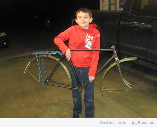

Christopher has outgrown his 17" 1963 Raleigh Colt, and this will be his last year on it. The photo shows what you often start with for an older English bicycle that meets specific requirements (this is a small men's frame, that should fit him for several more seasons, when completed). It will be restored, and made ready for a club ride this fall, and he will use it for next years tour.
