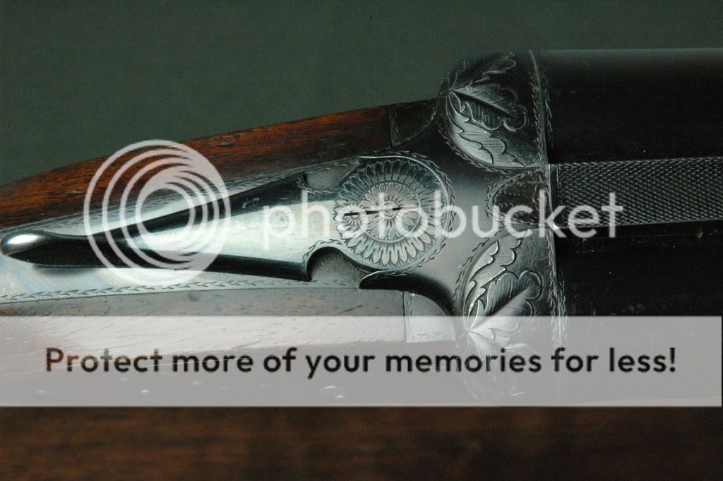

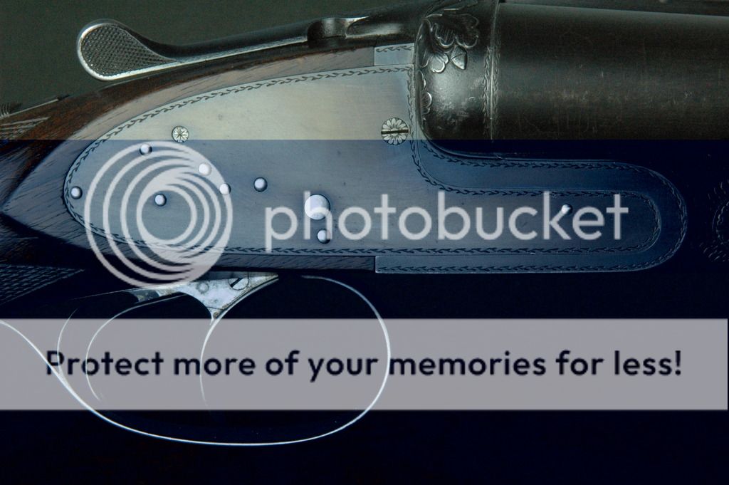

Several years ago I acquired this 12 gauge Belgian shotgun with 7-pin sidelocks. It has double triggers, ejectors, 2-3/4” chambers, and a hidden third fastener. It is a very high quality gun but shows some wear from normal usage. Looks like a Francotte to me. However it is not marked with a maker’s name anywhere on the barrels, frame, sidelocks, or forearm iron. There are an assortment of proof marks on the barrel flats along with the name of the barrel steelmaker which is hard to read but I believe that it reads something close to “Giltinplat Steel N”. The finish is somewhat unusual. The barrels are blued as are most of the frame and the sidelocks. However, the water table, standing breech, and double triggers are case colored. I am guessing that someone reblued the gun over the case coloring but if so how did they protect the water table and standing breech?
The frame is serial numbered “27477”. Each tube carries the serial number “27339” which I assume is the barrelmaker’s number. The bottom rib near the forearm lug is marked “477”.
I have photos in JPEG format but am unable to upload them to this site.
My main interest is to see if anyone can identify the maker or perhaps who the craftsman who made this gun on his own time worked for on his “day” job? Thanks.

9 pin sidelock?
Siemens Martin Steel & d datecode. Encircled 8 or infinity forward of the flats?
Cheers,
It was proofed in 1925. Nice gun in good condition.

Very nice gun, 7 pin sidelock, 1926, Siemens Martin Steel. 12 gauge 70mm chambers..
Typical trade made Liege sidelock, in much better than average condition on the outside.
Not a Francotte however.

Purdey Nose
Really need an image of the marks forward of the flats to the forend hanger to make a stab @ the mechanics involved.

Disc-set strikers with retaining screws. Another mark of decent quality.

Serialized tubeset also. Close number on water-table.

This is very good quality gun as evidenced by excellent polish on interior surfaces not seen when the gun is fully assembled. An Angliphile will say it is lesser quality because it is not stocked to fences, balls or breasts. Being European I do not share same point of view.

Possibly the E monogram(stylized EW?) on the tubes forward of the flats?

The initials "EW" are clearly marked on the water table. I have sent a photo of it to ellenbr who has been so generous in posting my photos to this thread. Would love to hear any more information about Emile Warnant. Also, is there a book available about the Belgian guild makers? In English? Thanks.

Culprit spangled EW on water-table. Quality piece with a set of proper tubes.

I had seen the EW star in one of the previous pictures.
And the style is very similar to my own gun.
The one I have has chopper lump "Poldi anticorro" barrels, and is stocked to the fences. It also has sidelocks made by Jacquet who was one of the top "platineur" in Belgium at the time.
