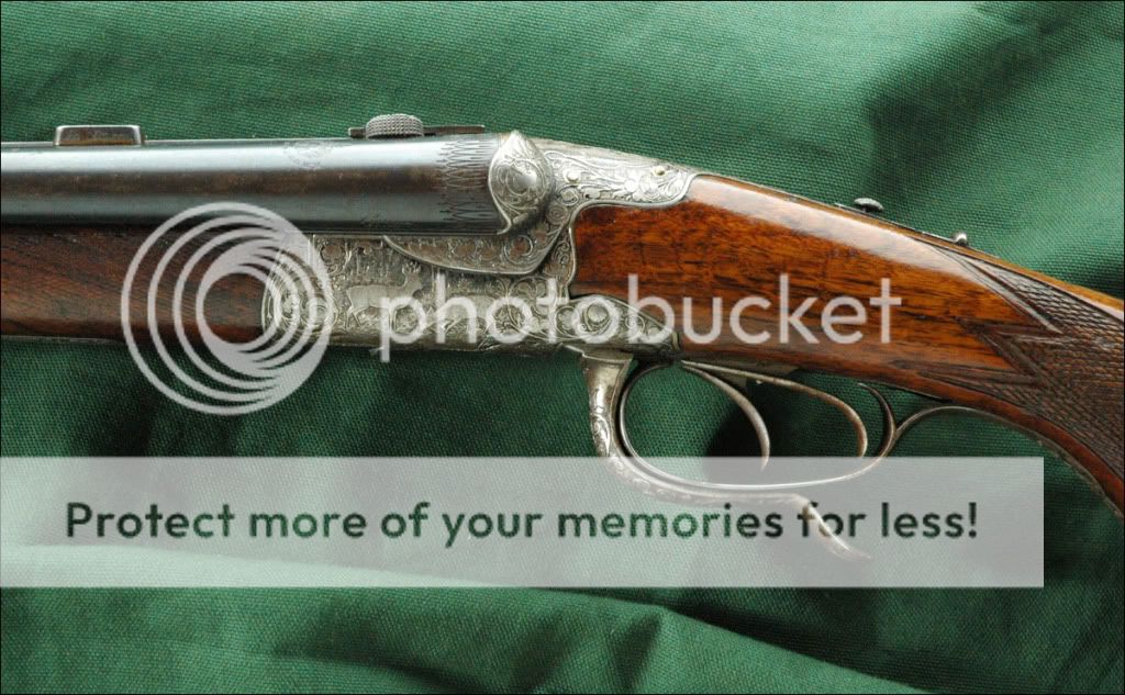

What I have is a drilling that needs some authentication work. I’ll try to explain and type what I see from my notes. The goal of my inquiry is four fold:
1. I want to identify the drilling’s rifle caliber by deciphering the markings. (I will then cast / slug the bore to verify it is still within safe standards)
2. I want to decipher the maker’s name and learn about his workmanship and history
3. I’d like to know what the gun might be worth.
4. I’d like to understand what the receiver of the gun looked like the day it was made. I believe it was a combination of French grey and case coloring, perhaps browned in some manner? I may wish to restore the gun and I’d like to get it back to the way it ought to be.

When I look under the forend the steel on the splinter forend appears to be case colored. When I look at the receiver most areas that look like rust actually look more like brown case coloring to me upon close inspection. Is it possible that the gun originally was case colored?

Also, I wanted to get some aesthetic opinions from the readers. The areas of the receiver "appear" from the photos to have rust on them but overall, the brown spots are not rust. They are some sort of coloring, perhaps a case coloring? Perhaps a shellack that has gone bad?
The engraving is actually very, very good even though the picture looks as though it is only slightly better than a guild gun. What has happened is that the ink/dye has faded or rubbed off and a great deal of the texture and depth of the engraved scenes has been lost. Any idea who I could get to "affordably" re-ink the engravings?
Could I strip the receiver completely with a solvent, acid finish it to grey and then have it re-inked by a decent artist to get it back to close to original?

Thanks. I think it is a neat gun too. I spent this evening doing a do-it-yourself restoration on the gun and I'll post the results in the next day or so.
The delightful suprise in all of this is that I was able to eliminate 99% of the surface rust from the entire gun and it looks excellent now.
In case anyone is interested to know what I did, I used #0000 steel wool on all the external metal while gently rubbing with generous amounts of gun oil. I repeated this process several times and found the results astonishing. No detail or finish was lost in the process.
After I used the steel wool, I used a gun degreaser to get everything extremely clean and dry, then used a trick I heard about from the gun engravers. I used a 2" long pink eraser all over the french gray receiver and boy is that an amazing trick. It cleaned all the micro fine (invisible) engraving cuts all over the receiver and it put the nice, consistent french grey look back all over the receiver.
Once I was done with everything, I applied lots of gun oil and admired it for a half hour. I can't believe how good the gun looks after such a simple process. It truly blows my mind that this gun is 99 years old and still in this condition.

Here is a link to the photos. It shows all the original "before" photos and the last dozen or so on a white background are the "after" ones. The proof marks are much more legible now.
I'm happy to say that all the numbers match on the entire gun! The lever, forend, barrel and receiver are all marked "30" for their serial #. One part on the receiver says "30L" which I suppose is either the maker or seller, whoever Mr. "C. LEB****, ****MBERG" is as shown on top.
