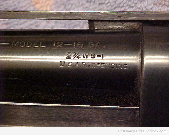

https://www.shotgunworld.com/threads/model-21-ws1-ws2-chokes.220825/
[Linked Image from jpgbox.com][/URL]

I believe the goal of the WS1 and WS2 chokes were to provide the optimum
20 yard and 30 yard patterns.
The WS2 seems better suited for Upland birds than a Skeet field.
Reverse your selectable trigger and shoot the out goer with your WS2 barrel and the incomer. with WS1.
I'd have a tough time believing that the guys who ordered these barrels weren't thinking Skeet

The first listings/ads for the Model 21 Skeet Gun in 1932, give the chokes as cylinder right and improved cylinder left. The next year the big W was touting the WS-1, WS-2 combo.
Wish my Model 21 Skeet Guns were WS-1, WS-1.

Terminal Flare in the WS1 barrel. Negative choke.
More open than Cylinder by a few thousandths.
WS2 at about .008
