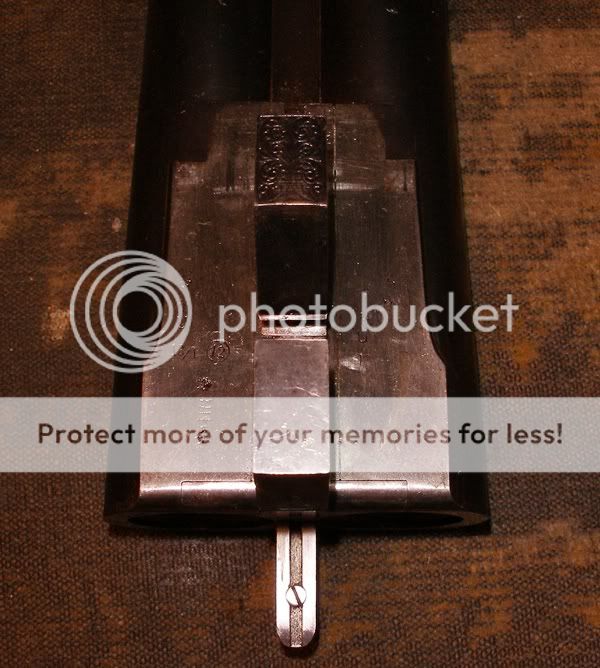

12 ga. Otto Geyger shotgun. Can anyone point to who made this action?

Any chance of getting a pic of the watertable & flats?
Posted By: Peter Weber Re: Otto Geyger shotgun. Who made it? - 07/17/08 11:15 PM
I wish I had a camera that could focus down that close. The barrels have a lone letter "s" just forward of the flats, as well as the 3 digit serial number. The water table has only proofs, a 3 digit serial number, and gauge listed. The outside of the barrels has only "O.Geyger, Berlin" and the word "Nitro".

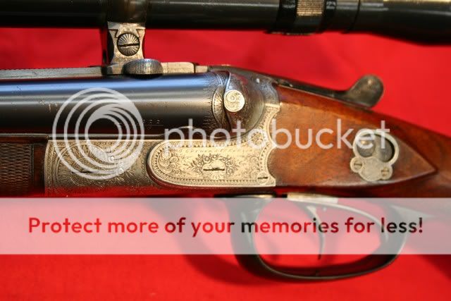

O. Geyger #1454 DR in 8X57 with the odd serial number sequence on the watertable. This is the highest number I've found.
O. Geyger with the "Sl" tube forge stamp just ahead of the flats. I still believe Berhnard Merkel played some part in the manufacture of these unique style frames as peddled by J.J. Reeb and other firearms merchants.

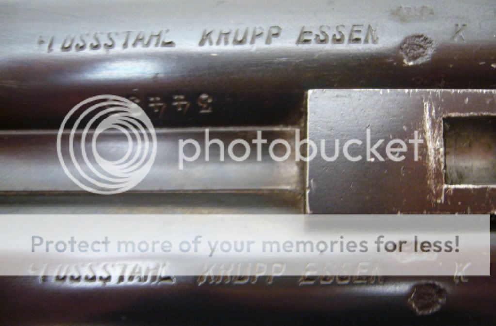

Here's the marks between the flats and the forend lug for Geyger #1454. Looks like the Louis Kelber mark of a "K" in a jagged circle, a script "M" near the forend lug and a script "E.W.". I wonder what the line across the "Krupp Stahl"(??) on the underside of the left tube might be as well as why it was finished that way?
Posted By: ellenbr Re: Otto Geyger shotgun. Who made it? - 07/24/10 10:09 PM
Interesting that the Mauser has Louis Kelber's marks as well as "E.W." and then "R.S."
Robert Schlegelmilch seems to have been a principal in Suhler Waffenfabrik Schlegelmilch & Metzner. And I guess Metzner to be one of Albin, Georg or Max or the possibility exits that he was Albin Georg Max Metzner and there were a couple generations. At any rate Suhler Waffenfabrik Schlegelmilch & Metzner was dissolved in 1901 and Suhler Waffenfabrik Robert Schlegelmilch emerged and existed till 1923.
Note that the O. Geyger has only a single "K" in a jagged circle while the Mauser tube has 2 stamps of the "K" in a jagged circle. I'd guess that the additional marks note additional effort and that a script set of initals just might mean a specific effort.
