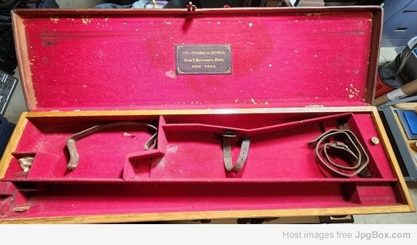

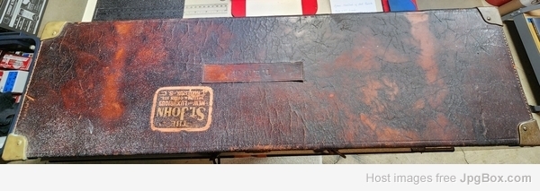

A friend acquired this old VL&D SxS case at auction and knowing I have a number of J. P. Sauer VL & D 'Knock about' SxS's. Leather and interior rough condition so I need to look into having it redone. Now to the challenge, I do not wish to invest the cost of a new high end SxS into getting it redone. Any suggestions?

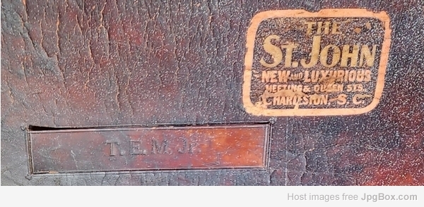

This label and the embossed name plate is rather cool

Well LeyFly you have a case that requires a large helping of TLC but it is far from needing a Leather recover job on the whole Leather is extremely resilient if you treat it correctly and take time over it. In this photograph many folks would say it is not worth spending time on it .
A lot of TLC and some effort the case can again look like it is looked after
Amazing what a re line can do and a couple of Bridal Leather straps having the correct Military roller buckles.
It is now the fitting keeper of of this period offering of the gunmakers art, actually it is just case window dressing..
I did do a step by step posting here of how to restore a Leather gun case (the one in the photographs) but is has now slipped into the past though it may still be found. My personal complaint is that when Dave Webber started the diy section it was to be a reference point for projects like this leaving me with the feeling I should not have bothered to take the time and trouble to do the number of these how to do it tutorials. A typical case of "Flash in the pan and failure in the barrel".
One day Webber may see some sense and bring them back to date, this is not the first time I have brought this subject up.
As for your case start the restoration with saddle soap and a damp cloth this will put back the moisture that the Leather is screaming for, do this cleaning about three times over a week. Next if you have any flaking leather use a small brush and some waterproof PVA adhesive to stick the flaking areas back down. Feed the leather with your choice of Leather preparation though I do prefer to use a quality hand cream, works well smells nice and a lot less costly. Finally dye the areas that stand out as bring lighter than the rest of the case. I also did a tutorial on how to re line and re fit the case inside you may be able to find that.
Good luck with your case if you do decide to restore it your self.
