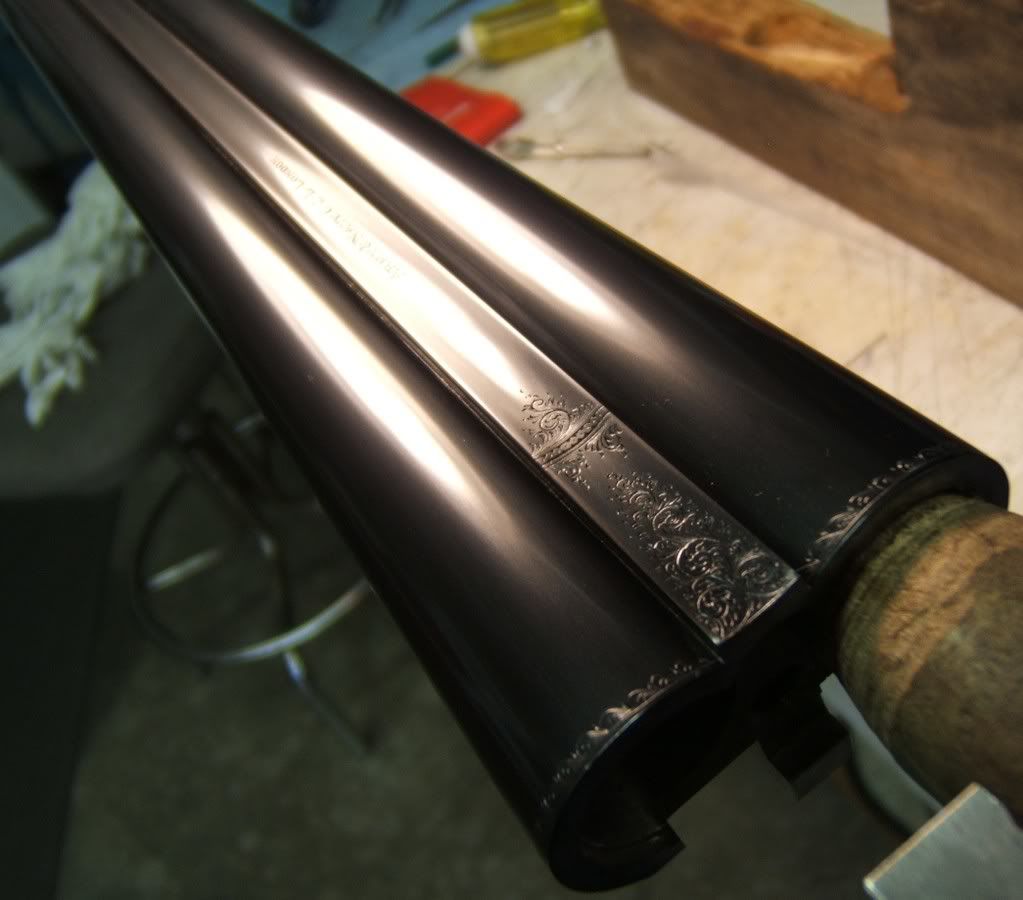

This photo is one of the above two barrel set, finished. Deep, dark blue/black with a distinct sheen or lustre.

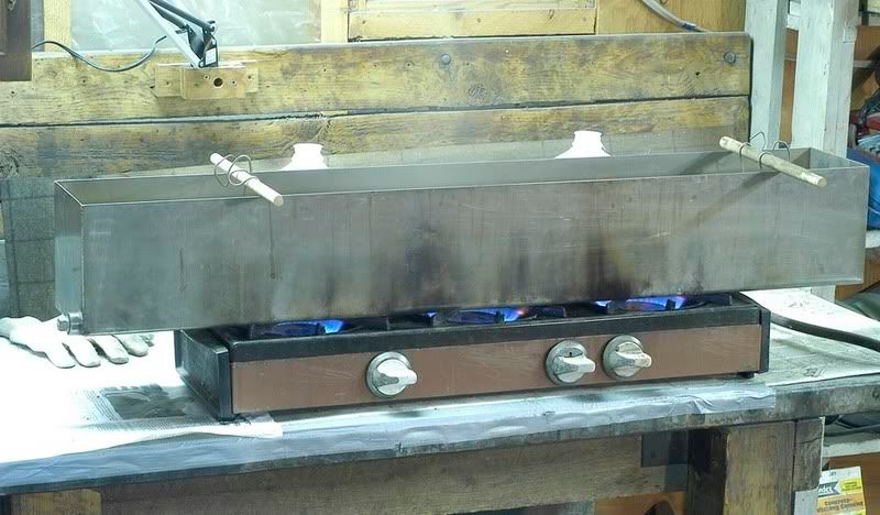

Kutter- it's normal to put the vial of solution in the boil tank when express, or hot rust bluing. Helps it dry faster.

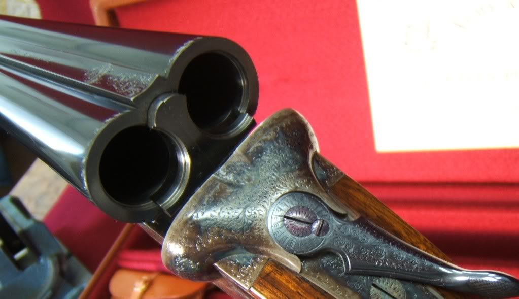

The pictures are abit grainy but the Holland came ot better than the A&N
