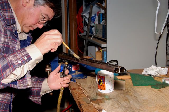

Another pic for the post.
I leak checked the ribs with soapy water and pressurized the barrels by putting air in the hole I drilled in the short rib behind the forend lug and plugging the bead hole with the bead. I couldn't find any bubbles anywhere.

I would like to add to the picture on leak checking that caution should be exercised in how much pressure to put in the barrels. I would limit it to no more than about 30 psi. There is a lot of surface area between the ribs. If you put 100 psi in there, multiply the area between the ribs times the 100 psi and you have the force that is pushing the barrels apart.
