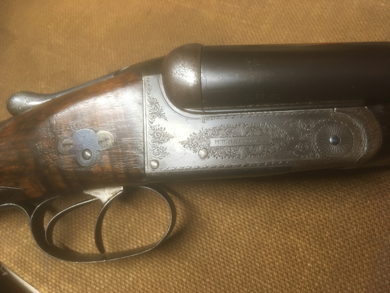

A few months ago I posted photos of a H&H rifle where the barrels didn't line up with the balls of the frame. Here's another. A Coggie.

I can see where it can still be functional, but for me it’s visually distracting. For that reason it would be hard for me to warm up to a gun like that.

Mike,
That is wild. Thanks for posting.
Dies the firing pin hit the center of teh primer. I ask because the current barrels are significantly smaller than the original barrels which drops the centerline of the new barrels.

The serial numbers on the barrels and triggerguard match. If they are a replacement set it was done a very long time ago.

Originally Posted by 85lc
Mike,
I imagine if the firing pins were bushed, you could compensate so that the firing pins were centered on the primers.

Just seems like a lot of high end work to produce a gun with mismatched action/barrels.

This is a very early W. W. Greener Anson and Deeley boxlock non-ejector, with round cocking levers.
Whilst it has been sleeved, the breech ends are still the original dimensions and are smaller than the breech “balls”.
It is not a one off, as there is a very similar gun pictured in Graham Greener's book at p.93 , illustration 140 and p.95 illustration 144.
