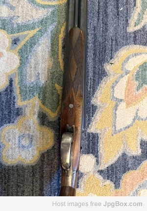

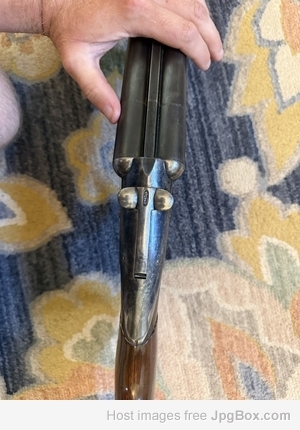

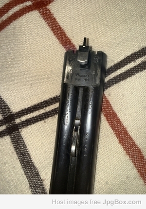

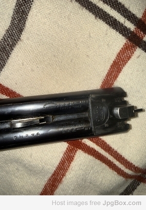

Hi everyone, Im new to the site and new to SxS. I just bought this Darne on whim because i thought it looked cool. I tried researching about it and everywhere on the internet tells me to come here.
I have a couple questions about it. Just to make sure, i think i saw from another post that if its a 5wXXX it should have been made from 1952-68?
Is there anything I should look for before going out and shooting it?
It was advertised as being Modified and full choke, is that normal and how would one go about checking which barrel is which?

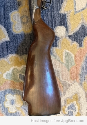

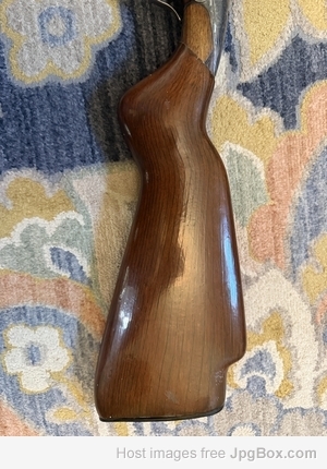

It has a stock sleeve? on it, would it be wise to try to remove the sleeve? I have no idea what they are used for. This one appears to be made out of rubber or plastic.
Were they shipped from France in cosmoline, because this one has a crap ton of residue in all the nooks and crannies that remind me of cosmoline.
Id really appreciate the help and would love to learn more about these shotguns, If you want more pictures id be more than happy to snap a few more.

Welcome. You’ve got a lot going on there.
The stock sleeve thingy doesn’t seem like it is removable. If you can get it off you might find the original stock is damaged or modified.
If the gun was sold new in Europe, the numbers of the serial number might be close on age. Guns exported were built out of sequence, and I don’t even guess anymore on guns sold here in the states, going by the serial number. There are some other clues, that I’ll get to in another post.

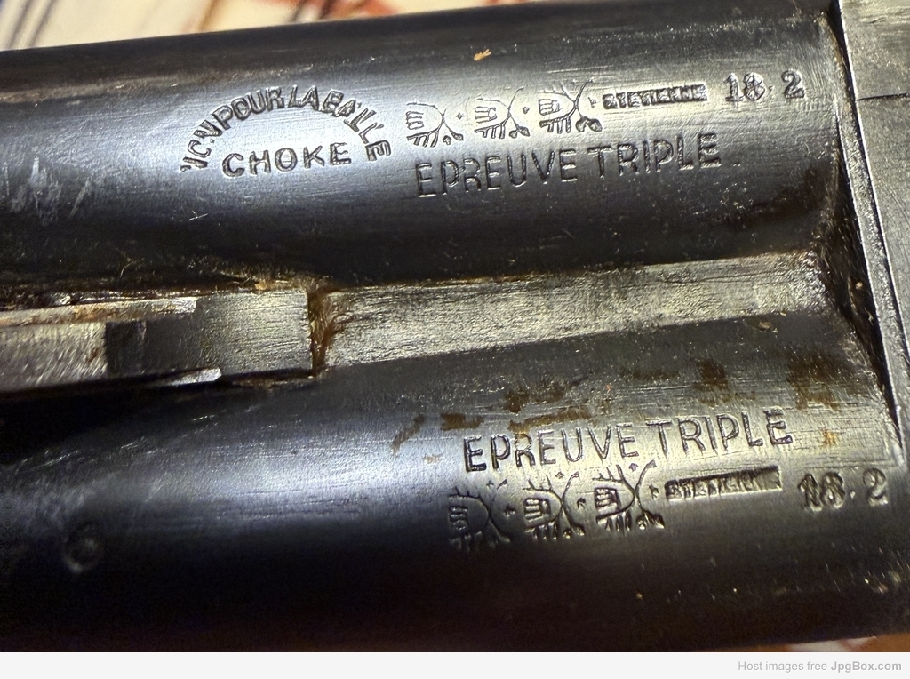

We need a bit clearer photos of the flats of the barrels to give you more information. About all I can see is that it is an R10 and it was triple proofed. Triple proof is the highest level of proof in Europe, and, depending on chamber length, you can shoot just about anything it.

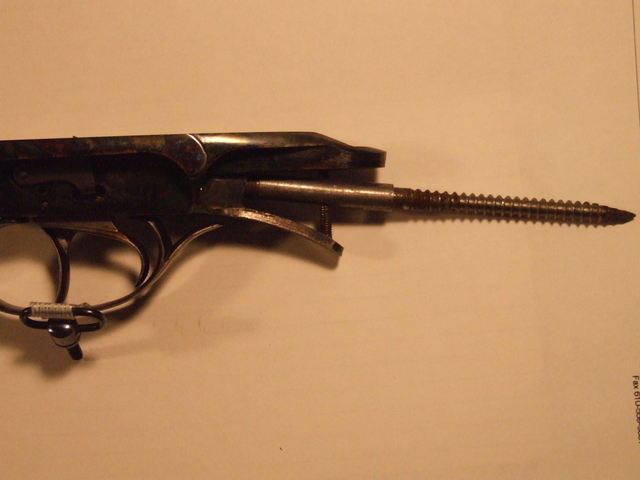

The key with a Darne is to get one that fits. You can’t bend the stock in a Darne to get the cast and or drop you need, as the is a big screw down the wrist. Don’t attempt to bend it.
[Linked Image from i.ibb.co]
We will wait around for your better pictures of the flats.

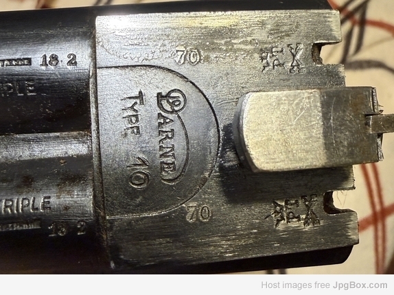

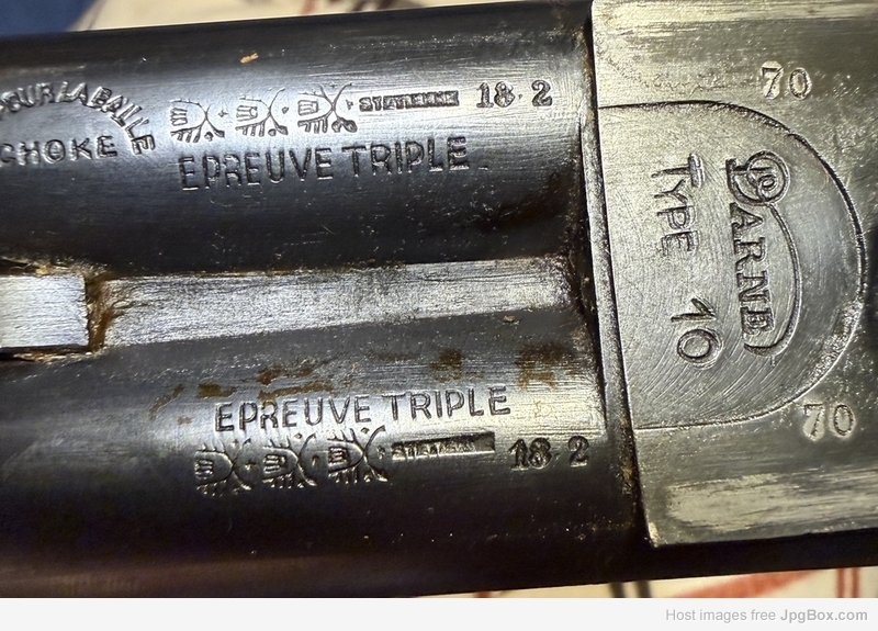

Hopefully these look a little better. My phone does not have the best camera.

That one is bulletproof.
The 18.2 tells us it is a 12 gauge. The “Non pour La Balle” marking tells us there is a tight choke in the left tube, and the factory didn’t want you firing pumpkin ball slugs in it. 70 is the length of the chambers, translates to good old 2 3/4” here. It was proofed in St. Etienne in a finished state with French proof powder T. Your gunsmith can measure the bores and chokes for you. The 18.2mm was measured 9” from the breech, is fairly snug for a 12 gauge, and if it doesn’t measure within a few ‘thou of that, now, the bore has been tampered with and the gun is no longer in Proof. Sounds worse than it is, most of the time, most Darne R models have a ton of wall thickness.
The cosmoline thing probably didn’t happen at the factory.
I’d use light loads in it, but, you do you. The gun itself is up to whatever 2 3/4” round you can find. Short of steel shot.
Might want to figure out what is going on with that stock, first, however.
Enjoy.
2 members like this: Parabola, TheCosmolineKid

A different buttstock seems to have been grafted to the original pistol grip.

Just from perusing this forum, you seem to be the expert on Darnes. Would you recommend trying to take the sleeve off the stock? I can get some better pictures of it later. I did unscrew the original darne butt pad off of it, and the wood underneath looked rough. I know little about shotguns and especially SxSs, I don’t want to ruin it out of curiosity.

Without seeing it, I’m in no position to even speculate what is going on with that stock. The picture I posted shows that MOST OF THE TIME, the stock is mounted to the action from the front. Hard to say what is going on here, without seeing it.

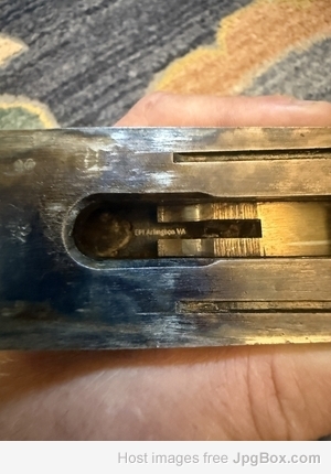

The only other spot that has any info besides the serial number is underneath that teeter-totter clip you push down to take the barrel off is marked EPI Arlington VA, which I understand was the importer?
