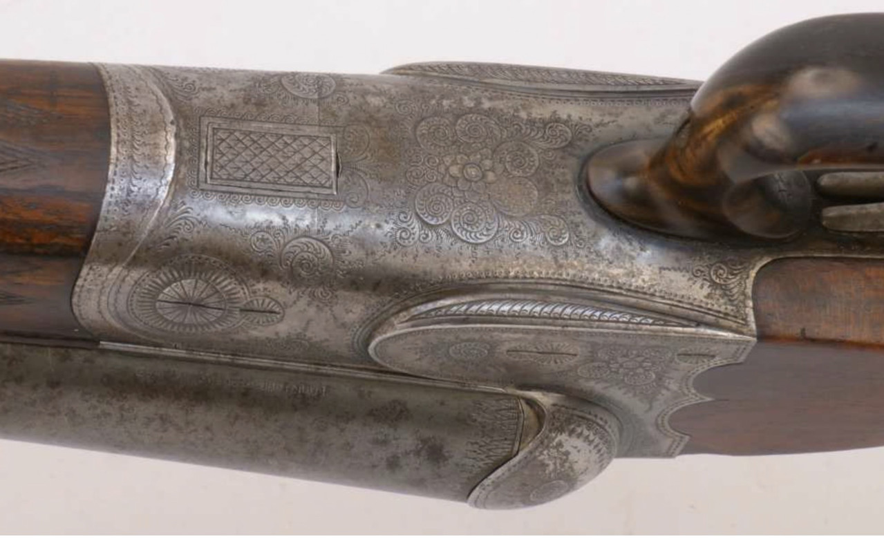

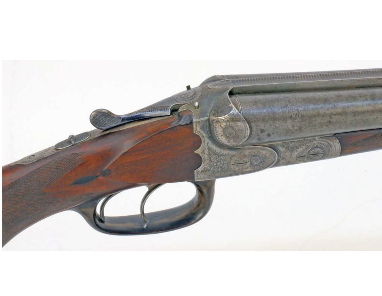

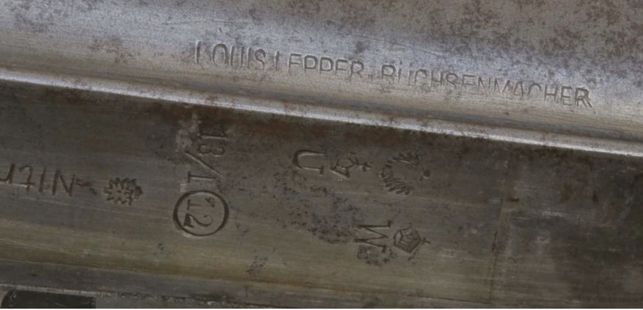

Just won this one for cheap, couldn’t pass it up it looked so close to my other 2 16 Suhl trade guns. I think it really just needs a good cleaning and maybe reblue barrels. How about date and mechanics?

Um, Cateyes atop the frame, ebony in the Church Windows & sideclips, what more could you want.... What a snag and you have broken the trend migrating to a 12 bore.

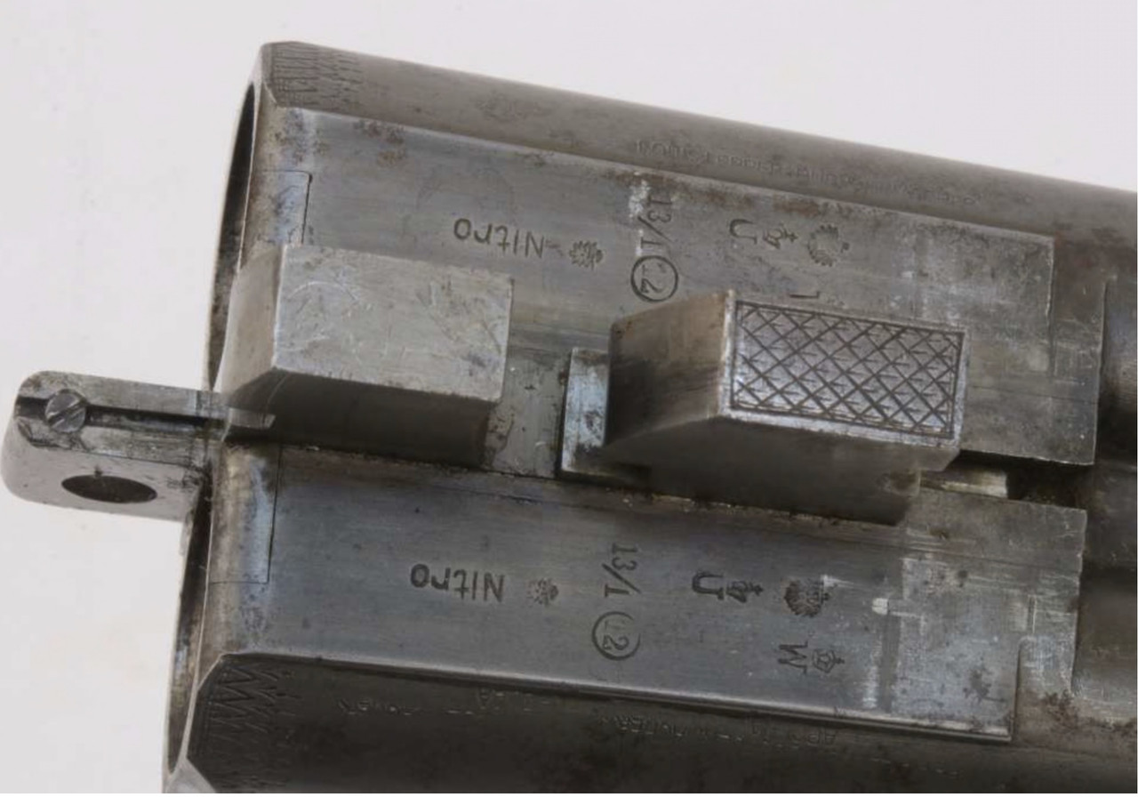

From the »Nitro« Stamp and position parallel to the tubes, I would hazard a guess of late WWI or just after. Say 1917/1918 and possibly into early 1919 from Suhl.

Looks like ole Louis Lepper inherited the business of Edmund Hügel of Apolda, Germany in 1911, or that was when Lepper hung out his Gunmaking Shingle. I have no idea where that might be, but it must be close to Zella-Mehlis. There are some reference to Louis Lepper being in Z-M, but this gun looks to be all Suhl. Lepper was a very common name in Z-M.

Thanks, 14.25lop 29.5in barrels 6lbs 5oz. Looks like a GI bring back that was just used as a daily driver and taken decent care of. Great engraving, horn, and wood out the door at less than 500.00 I just can’t stop buying these guns.

I have checked out Louis Lepper. The name is a "Firma" and was already used in Frankfurt am Main in 1868, but one of his heirs continued to use it. In Apolda. Which is situated between Weimar and Jena, and a quite interesting old town in its own right, with many remnants of former industry. You Amurricans maybe should think of "Silent Hill". That's close enough.

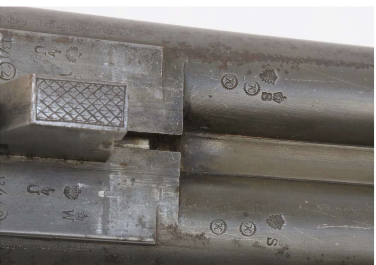

»Dietrich Apel in our many years of friendship, always told me that the stamp of a »K« in a jagged circled was the mark of esteemed German barrel maker Kelber, and there were 3 of them & I think they were heavily pressed into service in the mid to late 1890s? In recent years, along comes Axel E. and he gives, with a little Black Magic & Stroke of the Magic Wand, that much like our Cockle-Burr Plant, Germany too has a similar plant, and maybe the same, that has fruit/offspring/seed with »little hooked thorns«, just like our Cockle-Burr and Beggar Lice, that very quickly & easily attaches to the coat of passerby animals and clothing of humans; all of which transport the seed to a new growing area. Axel E gives that since the K is in a „Ratchet“, or jagged circle, it is a symbol for the Klette seed & if you truncate the »e« off the end, then it reads „Klett“ and represents the talented Klett family of tubemakers, specifically Heinrich Klett. Now too the Klett family was somehow associated w/ the »Acorn« and a similar tale evolves; i.e. Acorn Folk are the Kletts. Anyway, if ifs and butts were candy & nuts, well all have a Merry Christmas w/ 2 choices of Kelber & Kletts.«

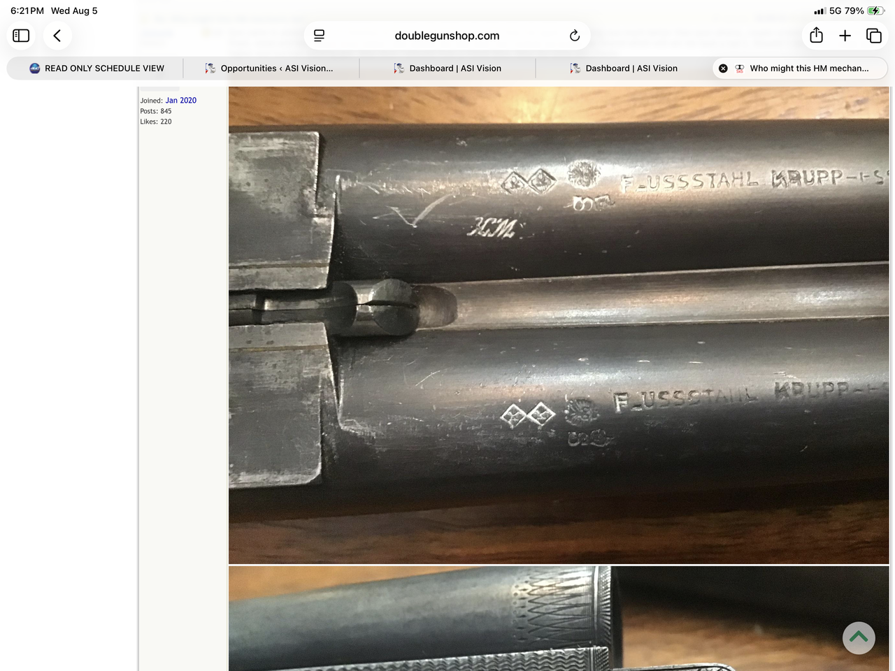

I think this is kelber
[img]http://[img]https://i.postimg.cc/xT3DQ0zF/IMG-3632.png[/img][/img]

I’m not taking credit, hell I got the information from you.
