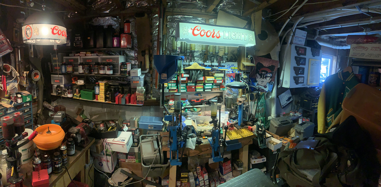

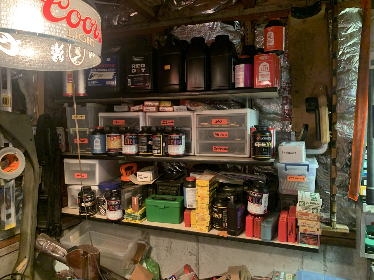

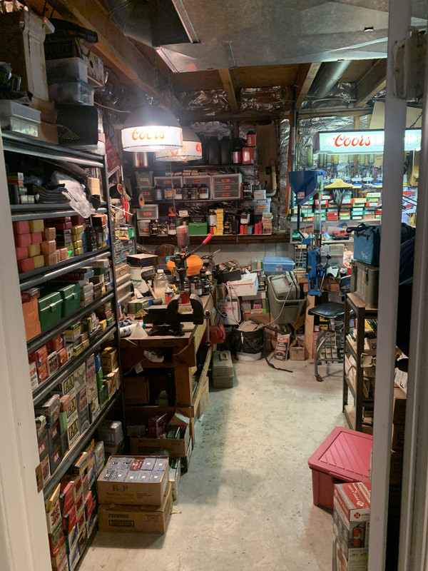

Don’t you guys read what is already posted before you comment?
I load by the 10’s of thousands and it isn’t a guess at what the problem is!

Yeah, I do. So, are we to be impressed with your accumulated mess?
