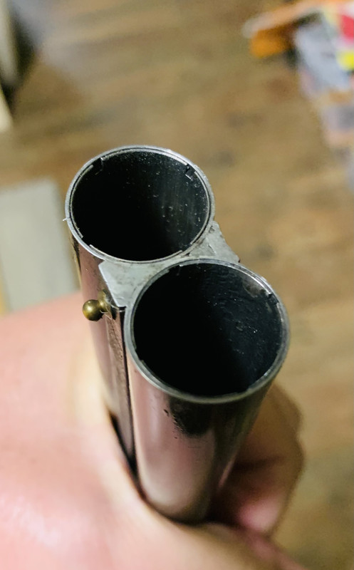

Found a Browning BSS with 30 inch barrels. Anyone had Briley put chokes for steel in one of these? Any thought or tips appreciated.

after factory tubing of any double gun is risky bidness, due to possibility of changing regulation of barrels...
better idea, is to alter chokes to mod and mod and shoot steel loads out of shells using latest wad technology...
plus, collectors don't like tubed guns...

Briley is expert at this, it shouldn't be a problem.

You don't need aftermarket tubes to use steel in a BSS. I've shot tons of no. 4 steel out of mine with nary a problem. One caveat. . . . if it has a full choke barrel open it to modified. Mine is now choked .018" and .018".
Roughly 15 years of shooting steel no larger than 4s. No issues.

I took it 1 step further. First I fit the 30" barrels to a "Sporter" frame (reducing the clubbiness by a factor of 2) and then I sent the 30 inchers to Briley

Ed, you are 100% correct, leave the gun alone, just don't use steel shot is the best way to go.

Ok thanks probley just shoot bismuth. $650 for chokes buys alot of shells.
