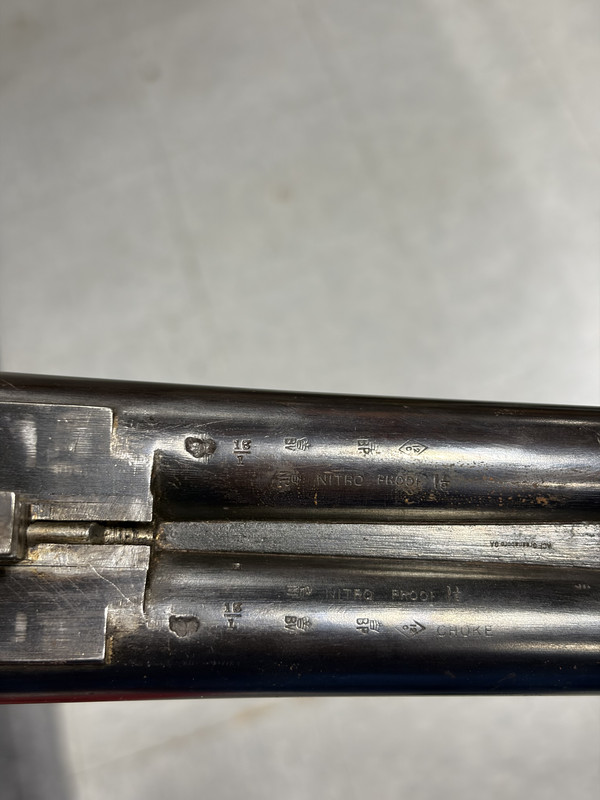

Gun described as "2¾-inch chambers with fixed chokes measuring full and improved cylinder."
Posts: 10,348
Likes: 159
Posts: 10,348
Likes: 159
Birmingham nitro proofs...

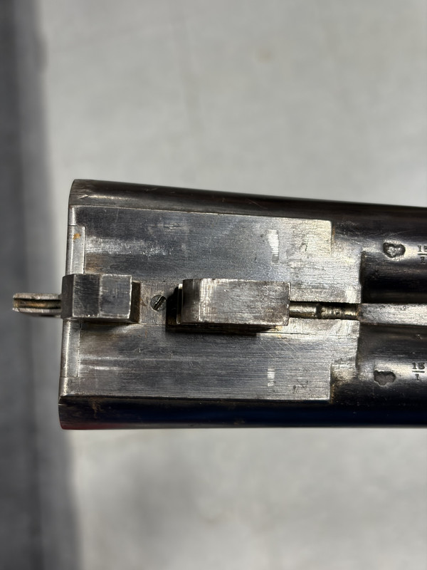

odd that stamps are not on barrel flats...
and to be safe, measure barrel walls in front of chambers...
if less than .090, seek professional advise...
is there a makers name stamped on top rib?

Does that say "vd wenachie, wa" on the lower rib (Vintage Doubles)?
1 1/8 Oz Nitro Proof, can't make out the Crossed Halbards to determine the date it went thru Birmingham proof.

ACF, Greensboro, ?? Was the importer.
That's what struck me as odd.
Cole & Son. Portmouth. Proprietor T. P. Trevor.
ACF Greensboro, VA
I don't even see crossed halbards...

Quite a few WR guns are marked on the barrels and not the flats. The gun is marked for 1 1/8 oz so it should be 2 1/2” chambers.
Ken
That was my thought...
what the chambers were is unimportant...
what they are now and is the gun safe to shoot with field loads, that is the question...
I agree...and I'm tipping towards the listing being wrong.
If the chambers had been re-done legitimately in England, it would have been reproofed. The gun is a recent import, so it's unlikely they were extended to 2 3/4" here.

Measuring error?

Originally Posted by ClapperZapper
Measuring error?
Something like that.
I passed bidding on the gun, so I'll never know.

an geoff, just because gun is recent import does not mean the chambers were not lengthened more recently...
key question...what are barrel wall thicknesses in front of chambers?

You might feed a gun that was originally 2&1/2" differently than you would one that was originally chambered for longer cartridges and designed to digest heavier loads Ed.
key question in guessing what are safe shooting specs for this gun......what are barrel wall thicknesses in front of chambers?
an note, chamber length is not stamped on barrel, which means two things...
a. barrels were proofed before 1925...
b. we do not know for sure what were chamber lengths at time of proof...

12C inside the device and 1&1/8" oz proofs, it was a 2&1/2" gun originally. If it was a 2&3/4" gun it would be marked 12LC inside the diamond or 1&1/4oz proof, possibly both.
Ed is always good for a laugh.
It most definitely matters what your gun was originally designed to shoot and how it was proofed. Those of us that have bought, sold and collected vintage British guns know that....and then there is Ed.

I’m going with measuring error.
I’m thinking that somebody imported a gun, and measured the chamber length with a crude drop in device or 6 inch ruler, rather than getting out a Hosford‘s.
Usually, the simplest explanation is.
Posts: 9,884
Likes: 521
Posts: 9,884
Likes: 521
1896 Rules
1904 Revision, and as said 1 1/8 oz. would be for 2 1/2" chambers
After 1925 the chamber length was marked
After 1954 in both inches and mm and simply 12 in the diamond without the C or LC

I had not recalled correctly that the LC was only for chamber over 3" long.
