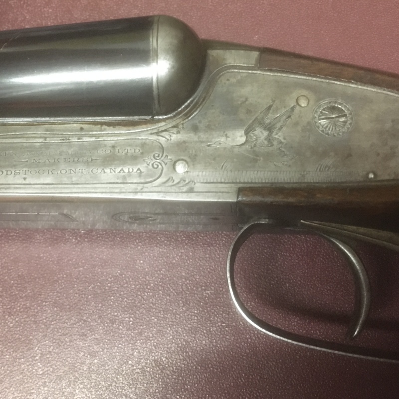

Ted, I have collected the gun but not shot it as yet.I have taken some pictures as asked. I have also added the Holts illustration to my original post now I can use IMGBOX.
With Krupp Fluid Steel barrels it appears to be the $70 Trap model. It has a broad file cut rib with a tiny mid-bead. It weighs about 7 1/4 pounds.
British proof in 1971, possibly when it was imported but perhaps so that it could be could be sold on to a new owner.
The “cracked at hand” appears to be this small crack behind the top tang and which appears fairly superficial.
