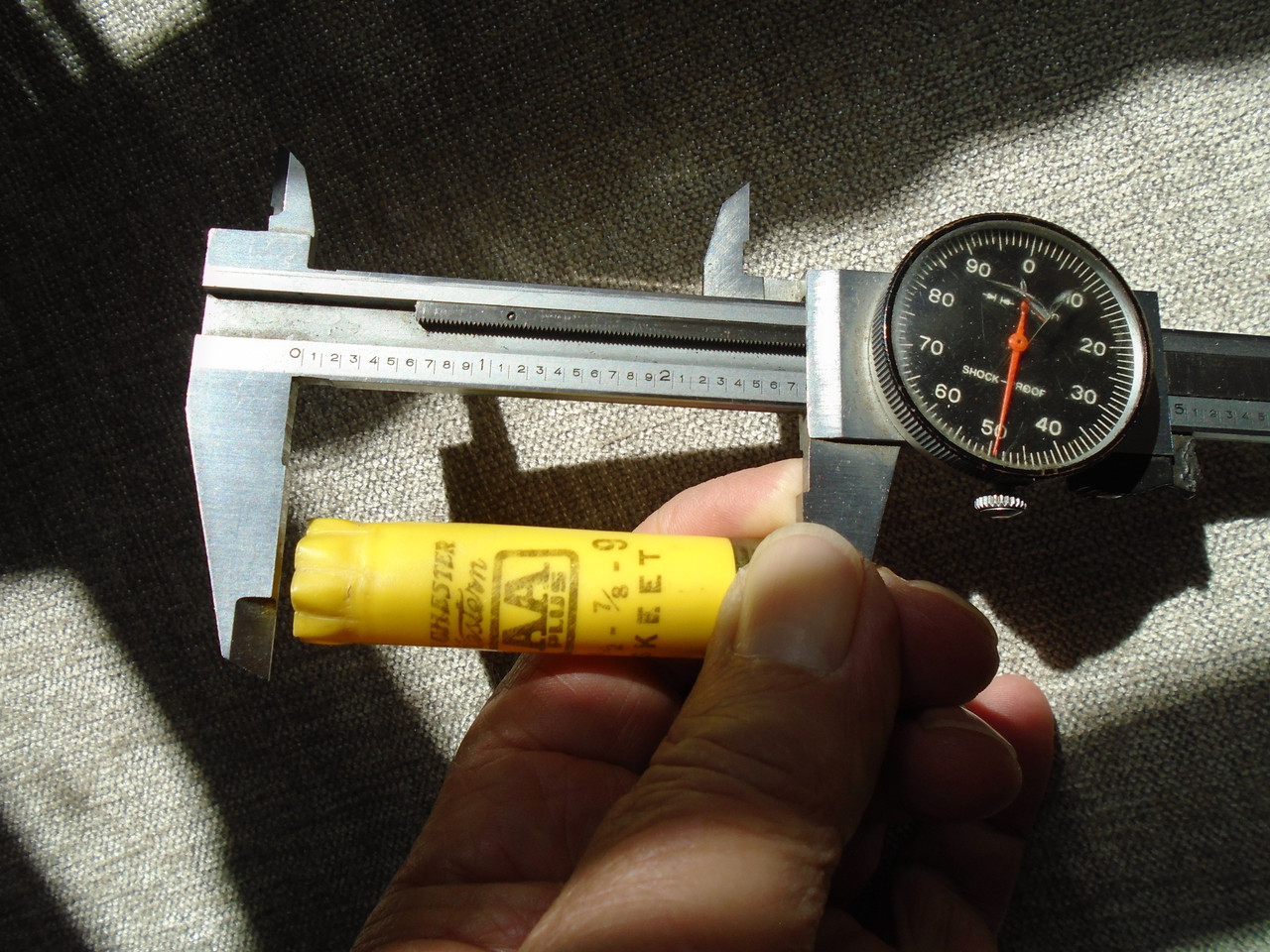

I shoot old AA's in my 2 1/2" Model 12.Shoot and eject fine. [Linked Image from i.postimg.cc]
