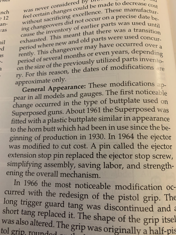

The answer appears to be 1966...I'm digging in to confirm that...and wanting to learn why the change was made.
Posts: 790
Likes: 105
Posts: 790
Likes: 105
This is incorrect, I think. Once I had a starting place, I found this:
...so 1964.
