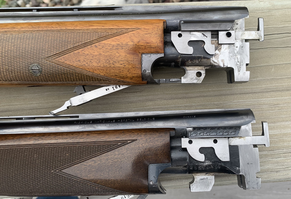

The photo above shows the receiver end of the barrels of two Browning Superposeds.
The top one is a 12 gauge 1959 Lightning, marked Browning.
The bottom one is a 1974 Fabrique National Superposed.
The top one has - as shown - a two piece construction. The FN gun on the bottom is one piece, and lacks that screw.
My daughter's 1971 20 gauge Superposed Lightning is the same as the 1974 FN gun - so the change happened between 1959 and 1971.

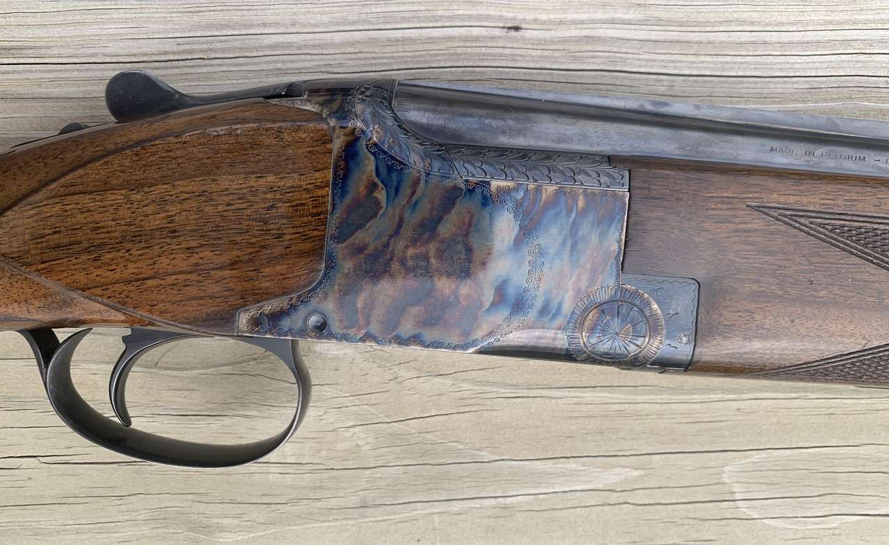

For Superposed fans: The FN gun is sweet - 7.2 lbs and case colored with minimal FN B25A1 style engraving:

Was your A-1 case colored at the factory?
Posts: 790
Likes: 105
OP Online Content
Posts: 790
Likes: 105
Impossible to tell, but I'd guess so.
The engraving is crisp and clean, with little evidence of wear of a removal of bluing and cyanide case coloring. There's enough wear on the bluing on the tang, and minor bits of wear here and there that I'm guessing the gun is in original condition...it just hasn't been shot a lot.
I have heard it's possible to get a letter from Browning on guns sold under the Browning name...I have no idea if that's a thing for guns sold in Europe/England as Fabrique National guns.

The answer appears to be 1966...I'm digging in to confirm that...and wanting to learn why the change was made.
Posts: 790
Likes: 105
OP Online Content
Posts: 790
Likes: 105
This is incorrect, I think. Once I had a starting place, I found this:
...so 1964.

I also found an answer for this:
So the gun is a B25A2.
It does appear to have a Superlight forearm:
...but Superlights are only supposed to have 26 1/2" barrels...
