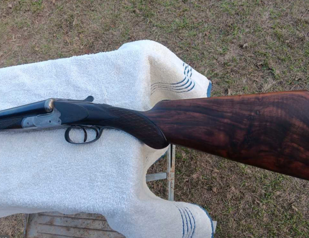

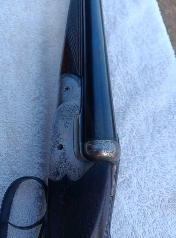

Just bought this French 16 listing says no maker. I always thought this action was called/ made by Brueil, but not sure since he was a barrel maker? Will have more information when arrives but looked like a no brainer to me. Any information would be appreciated. Thanks in advance.

Great Grab. That Wood is Stellllllarrrr..... Looks to be the quintessential St. Étienne Anson & Deeley Body Action w/ 1/2 pipe side frame reinforcement. My hope it that it has the feather weight tubeset....

I do wonder the date where the mechanics @ St. Étienne fully adopted the Anson & Deeley Body Action...... It is the pinnacle of platforms. The trouble w/ the cheaper Blitz Platforms, and others, is that the trigger pull becomes heavy over time & is difficult to regulate.

Really nice looking gun. Will need pictures of water table, barrel flats, the usual advertisement do-dad stamps on the barrels, any maker stamps, etc. Assume the barrels are the French standard 27.5" (70 cm) and the chambers the mostly usual 2 1/2" (65 mm) (If the gun has been in the USA, check to see if chambers were lengthened, a common occurrence).
The checkering on the half-pistol grip is very French - it is skip line checkering creating a Scottish tartan effect. Wingshooter many years ago said it was called "quadrille Scottish" In fact that would be "quadrillage écossais" - the term for Scottish tartan - in French and used to describe the checkering on stocks.
Chokes likely will be Full/Full unless it has been in the States for awhile.
