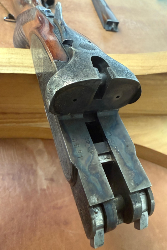

pls advise any insights you may have regarding this fine Austrian made gun...

1st, I really do not have any knowledge of firearms merchant Leopold Oppenauer of Ried, Austria( I assume it is Ried im Innkreis??).
I can't really read the preliminary datastring on the lower rib, but it looks to be dated in the late 1920s? If so, Austria, and a bit later Hungary, had a rules change in 1929 where the new Austrian Proof Rules appeared on August 14th, 1929 and became effective on September 1st, 1929. So this may be a transitional gun as far as proof rules go.

For the 2nd Proof Effort w/ the tubes joined and the Preliminary Datastring was applied forward on the lower rib.
8.0 grammes of powder and a 48.0 gramme Ball
And the Coat of Arms of the province of Carinthia was applied. Note this one stamp covers effort on both joined tubes.

And a similar stamp was applied. The above is an early version and the one on the flats of the subject gun looks like a throwback??
Again, this covers effort on both tubes. & I'm quite certain that the Final Datastring was applied here - 1931 for this one.

Leopold Franz Oppenauer is/was still recently listed as an active gunsmith and gun shop in Ried im Innkreis, Upper Austria.
This is a prewar Ferlach gun retailed by Oppenauer, as suggested by Raimey in a more elaborate manner.
The set trigger indicates the gun also had another set of barrels, likely a shotgun/rifle combination or possibly a DR.

Very nice gun, with attention to detail. Interesting that it was reproofed in Austria in 1996 (if the last letter of the code is an "H").
