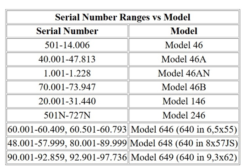

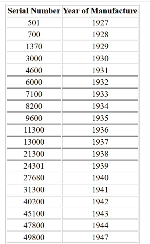

https://www.rex.gl/serials.html
from defunct page - skydevaaben.com
If indeed this Modell 46A was made in 1942, it has seen little, little action......
