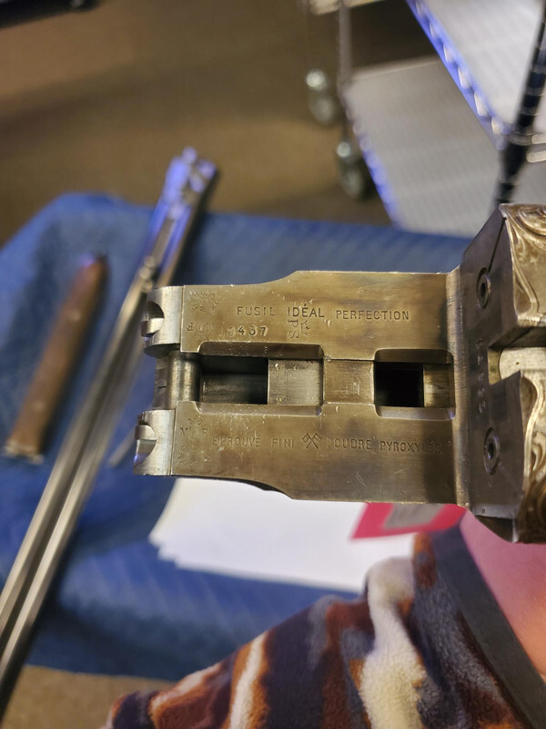

After reading Martin Godio's book and several emails back and forth to clarify different points, he concluded mine is a 7RE-C Perfection. My original thought 12 years ago was that it was a 6RE-E.
It would seem odd that my gun is not a Perfection when it is stamped "Perfection".
Salut,
L'Idéal Perfection REC a toujours eu 2 caractéristiques qui n'ont jamais changées. La première étant le renfort de crosse, type as de pique. Et la seconde étant les 2 ailettes de renfort relevées sur le canon alors que sur votre fusil elles sont relevées sur la bascule.
La deuxième photo des plats de canons indique que ce sont les chocs qui sont perfectionnés (améliorés).
N'ayant pas le numéro de série complet pour cette arme, je ne peux pas vraiment vérifier sa date de fabrication sur le registre des fusils 6 REE.

regrettably, my track record for rendering photographs on this site is pretty grim - i will attempt to send some stuff to james via email - several photos from the auction company.
would someone please translate fab's comments for me....the suspense is killing me.
my guess as to what he told james, is that the use of the word(s) "perfectionni" is related to the chokes. several of the french choke artists incorporate something about perfection in their proof copy. if my email of photos is successful, one will show that the watertable of #26331 is boldly stamped "FUSIL IDEAL PERFECTION", and in my very limited knowledge i assume this is the critical mark.

Google translate of Fab's post.
Quote
Hello,
The Ideal Perfection REC has always had two features that have never changed. The first is the ace-of-spades-style buttstock reinforcement. And the second is the two reinforcing fins raised on the barrel, whereas on your rifle they are raised on the receiver.
The second photo of the barrel flats indicates that the shock absorbers are perfected (improved).
Not having the full serial number for this rifle, I can't really verify its manufacturing date on the 6 R
A couple things interest me with this. First, never have I run across saying that only Ace of Spades guns were given the name "Perfection". Fab is correct that on my gun the sideclips are on the receiver and there is a slight cutaway on the barrels where they meet. The other thing is Fab's referencing lists, by serial number, of Perfections, of 6RE-Es. I have never heard of such lists existing. Would like to find more out about that.
I switched my understanding of my gun's designation from 6RE-E, which took several years to determine, to 7RE-C Perfection as a result of Martin Godio's research into models as shown in the annual catalogues. One of the interesting points he appeared to have discovered is at the upper range of the grades, things were only what they were called that year as listed in the catalogue. And that might change year to year.
