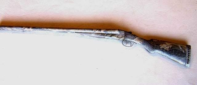

No need to hunt in shame... unless you do this to it:
