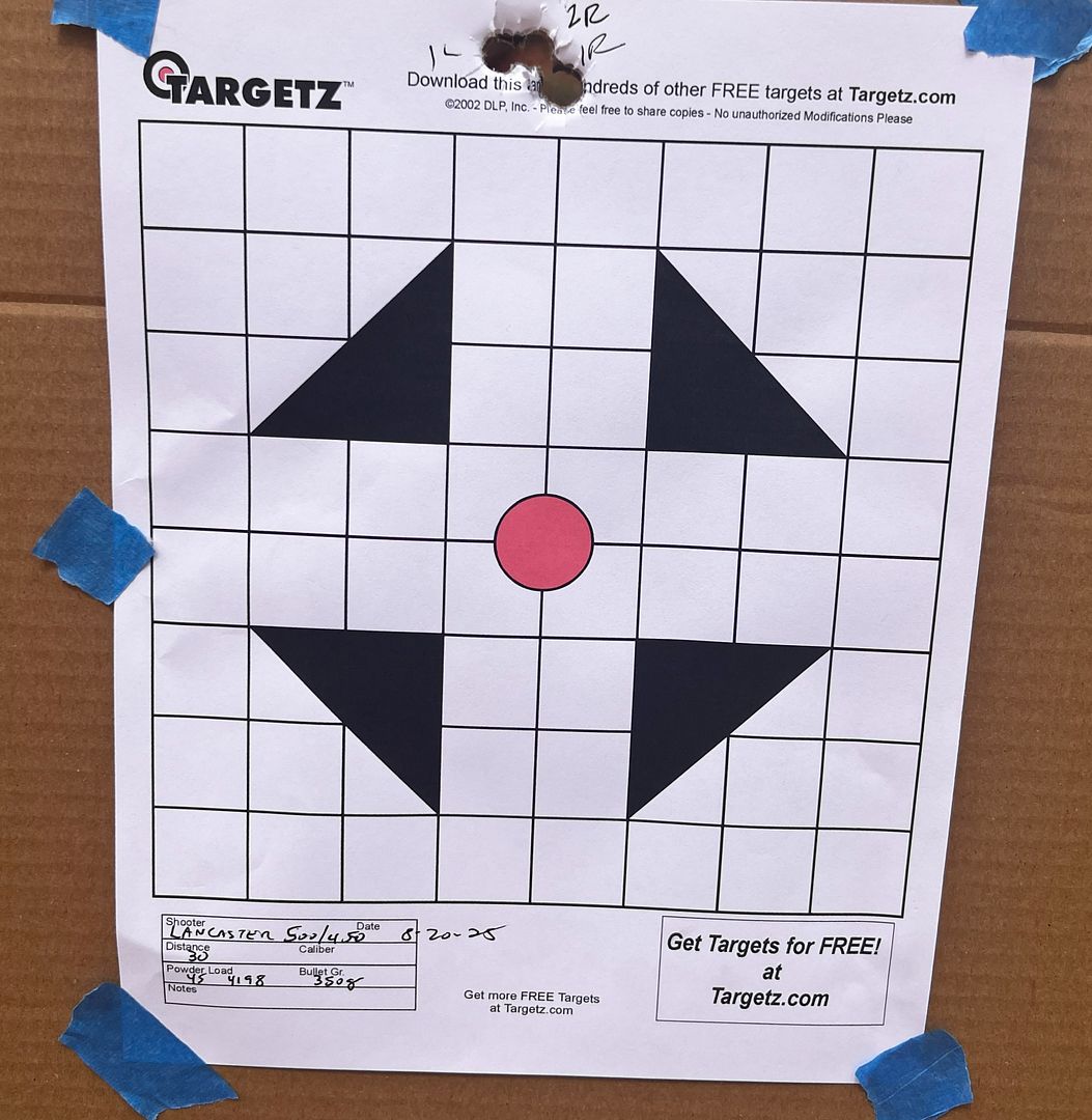

I was quite excited to try 5 previously formed cases as live rounds in the 500/450 rifle. Load was 4198 with kapok and a .458" LFN 350gr bullet. First 3 rounds were touching. 4th opened it up and I don't think I pulled that one (who knows?). 5th came back to the original 3. So the 4 were 1" center to center, but the 5th opened it up to 2". Range 30yards. Very promising.

The 500/450 and some promising early results with 350gr lead bullets, unpatched, and 4198.

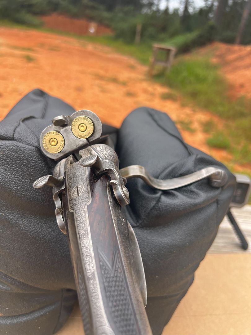

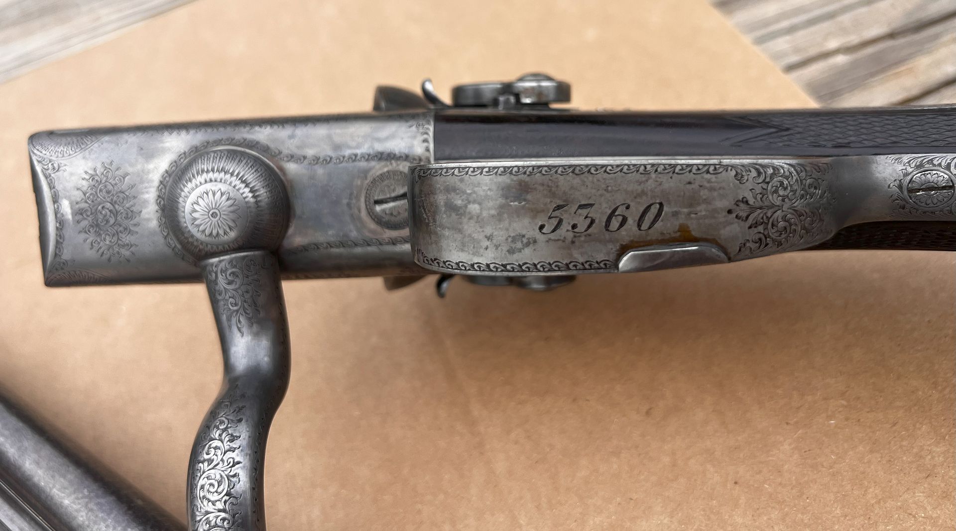

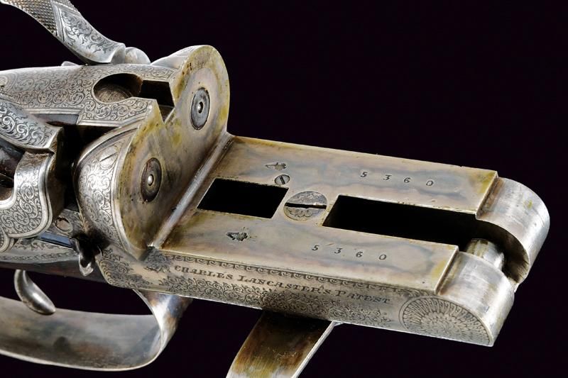

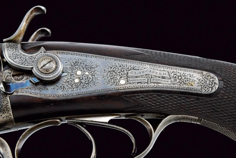

Here are a few more pics of the earlier Lancaster, in 500/450 3.25" that I've been working to form cases for from 500/416. So far, the few rounds I've completed and fired have shown promise that this rifle will shoot as well as it's new brother, the 450BPE.
