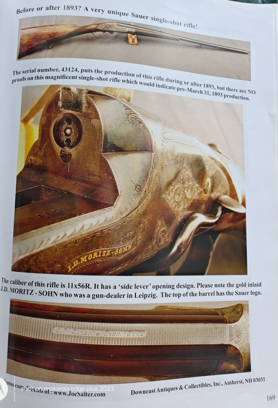

J.D. Moritz retailed Kipplauf - Sauer #43xxx sourced - lifted from page 169 of Cate's Sauer Text. So it is pre1893.

How can we tell whether it is original to the rifle or a later addition?

Well, we don't. But the preponderance of evidence suggests it is original. Sauer was including such as early as 1892. The Gun is given that it doesn't wear any proofmarks. Unless the German law is that you can alter the gun, alter the standing breech and it doesn't warrant proof, then indeed it is a later addition.

I don't recall that Herr Steinerstauch(?) in Wuerzburg sent my Sauer BF to the proof house when changed it over after it pierced a primer. I will check it out when I go to the basement.

So Ford, let me see if I can understand this segment of the German Proof Law: I can drill a hole in the standing breech beside each striker & it doesn't warrant reproof?? Can I get an affidavit on that?

I pulled the Sauer BF out and it didn't have any indication of having been sent back to the proof house. BTW. this is the same BF I spoke about that is chambered for 9.3x72R S&S that I used for years with 9.3x74R, shooting at least five of my Red Deer with it before figuring out it is really the S&S cartridge.
