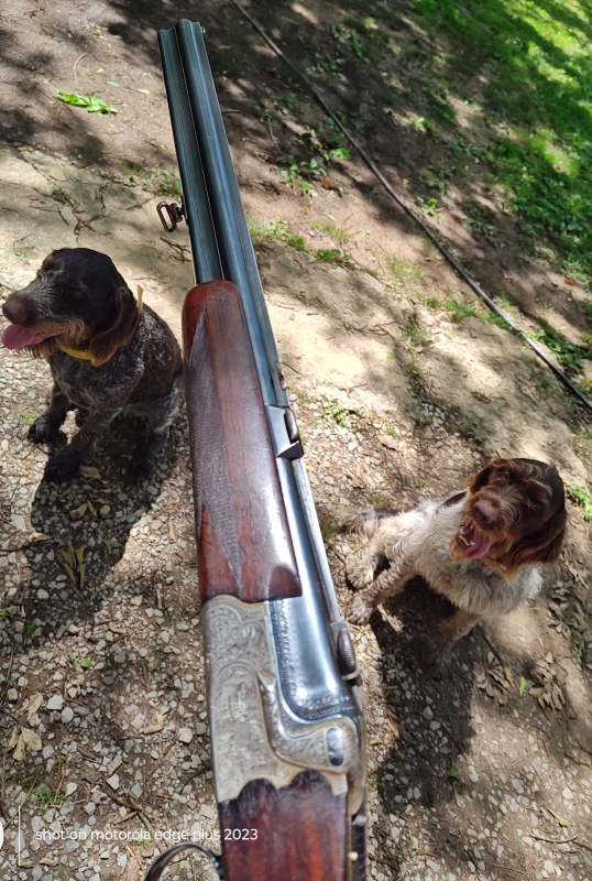

Some kind soul graciously allowed me to take this August Jung Viernau - Thueringen retailed 5.6x61R vom Hofe Super Express War Trophy off their hands.
62 cm tubeset w/ 36 cm LOP
5,5mm
61mm
539
891
5,1 gramme bullet(K.m.G.)
Krupp up top & Böhler Spezial on the bottom.
Blitz Platform w/ Non- Auto Safety
Any starting load data coupled with a bullet weight & diameter would be most appreciated¿

Assembled Kombo weighs 3.03 kg & tubeset weighs 1,461 grammes, but of course there isn't a weight stamp.

Looks like a beautiful and high quality gun.

Indeed & all the Kombos have 62 cm tubeset length, are quite similar in shape & form, have the 1/2 Pipe Side-Frame Reinforcement & according to Axel E. they were made by Christoph Funk, but the bulk of them passed thru the Z-M Proof Facility and one just doesn't see Christoph Funk's mark. Of course it could be hidden & gearing up for the 2nd Major Disagreement in Europe, the Suhl Proof Facility might have been very busy with instruments of War?
Axel E. also notes the following:
>>The DEVA once listed two pressure tested loads:
70 gr Hornady, 51.5 gr IMR 4831 for 3540 fps
77 gr Gehmann original, 53.2 gr IMR 4831 for 3500 fps
As the cartridge is known for Secondary Explosion Effects, downloading is advised against.<<
