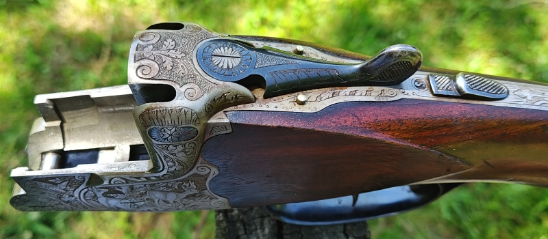

Some kind soul graciously allowed me to take this August Jung Viernau - Thueringen retailed 5.6x61R vom Hofe Super Express War Trophy off their hands.
62 cm tubeset w/ 36 cm LOP
5,5mm
61mm
539
891
5,1 gramme bullet(K.m.G.)
Krupp up top & Böhler Spezial on the bottom.
Blitz Platform w/ Non- Auto Safety
Any starting load data coupled with a bullet weight & diameter would be most appreciated¿
Hochachtungsvoll,

Assembled Kombo weighs 3.03 kg & tubeset weighs 1,461 grammes, but of course there isn't a weight stamp.

Indeed & all the Kombos have 62 cm tubeset length, are quite similar in shape & form, have the 1/2 Pipe Side-Frame Reinforcement & according to Axel E. they were made by Christoph Funk, but the bulk of them passed thru the Z-M Proof Facility and one just doesn't see Christoph Funk's mark. Of course it could be hidden & gearing up for the 2nd Major Disagreement in Europe, the Suhl Proof Facility might have been very busy with instruments of War?

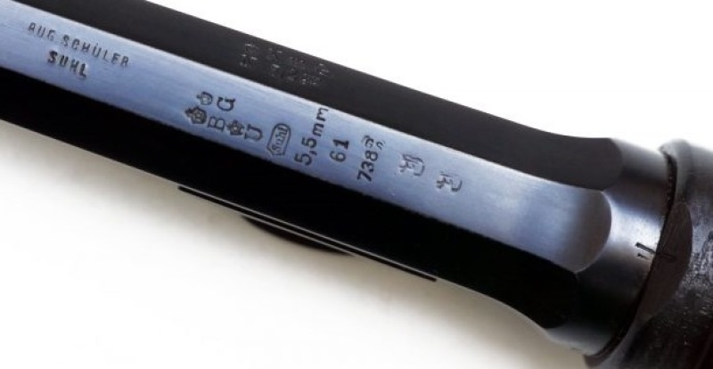

Too, most of Z-M stamped touchmarks I have viewed give a 5,1 gramme(79 grains) projectile. I realize there's not a huge difference to the 70 grain. I guess maybe the bullet weight & powder charge were the same number, just move the decimal, just to make things easy?

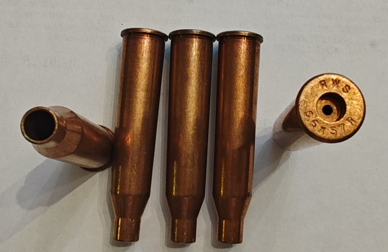

I have read that some have used Nobel No. 0 powder years ago w/ the 70 grain bullet & H870 for the 77 grain.
Hofe originally advertised the 5,6X61 Vom Hofe Express as pushing a 77 grain bullet w/ 54 grains of Rottweil powder @ 3707 ft/s. I do wonder which Rottweil??
How would a choice of Vihtavuori N165 or N560 strike you???

In the last RWS handbook of 2002 (9th ed.), the rightly famous "Blue Bible", the two recommended propellants were R 907 and R 904. While R 905 was emphatically warned about, as dangerous.

Raimey, At the time Gene started loading IMR 4350, many of the current powders didn't exist. It still works, but that doesn't mean none of the newer powders will. I don't know the color code of the chart and I don't know what powders you have in your cabinet. If you blow up a rifle, try to pick one that is not as nice as the Jung.

But what puzzles me is that all but one of the examples I have viewed passed thru the Z-M Proof Facility vs the one that passed thru the Suhl Proof Facility. Some were in the final state as the one below & the initials >>GS<< are very, very common on many including tip-up versions.
This August Schueler was retailed by a Berlin Retailer Waffen Scherell and has Cats engraved on it so some say it was a High Hill Cat Gun?

Ford, it is most easy to distinguish one cartridge from the other: one version has a R(Rand-Rim) and the other does not. Quite simple herein.

Ford, it is most easy to discern between the 5,6X61 vom Hofe and the 5,6X61R(Rand) vom Hofe: One has a Rim(Rand) & one does not. Sort of akin to a dog w/ a tail & a dog without a tail....
I finally found my brass & dies plus I have some Rimless so I need to source a bolt gun.....
Hochachtungsvoll,

Raimey,
The box is marked 5.6x57R, Is the rifle 5.6x61R vom Hofe or 5.6x57R? Are you looking for a 5.6 x 57 or 5.6x 61 vom Hofe bolt gun? I think I have some fired 5.6x57 cases, if you need them and maybe some 5.6x57R also. I can stake you to some 5.6x57 ammo to check your handloads against. The biggest advantage goes to the 5.6x57 over the 5.6x61 vom Hofe (both rimmed and rimless) because it uses .224" bullets and a common case head diameter. BTW, I noticed two of the fired cases have the unique venturi shoulder. This is more common on the 7x66 vom Hofe, than the 5.6 x61.

Ford:
Just seeing if you are paying attention. Yes, the rifle is stamped 5,6X61R but about 20+ years ago someone proffered me several boxes of the aforementioned 5,6X57R thinking those would bridge the gap in a Vom Hofe and those were the brass for which I was searching for but do not fit in well with what I am trying to do. How difficult it is to put a Rim on a Rimless??? I am quite confident I have a handful of 5,6X61R laying about somewhere plus I still need to order some of the bullets you posted & referenced.

Anyone hazard a guess how the RWS 5,6X57R might compare or contrast w/ the 5,6X61R vom Hofe Super Express??? I believe the RWS 5,6X57R was loaded w/ R907.
Hochachtungsvoll,

any such comparison of those 2 calibers will depend on the bullet weights and other factors, I will not hazard any guess here.
RWS Wiederladen (the "Blue Book") has data for the 5,6x61R, but only for the 4,6 g (app. 70 grain) bullets intended for the .22 Savage HP (5,6x52R), noting that these bullets are on the soft side.
Min and max loads with R 907 and R 904 are given.
Then there is this note: for internal ballictic reasons (whatever these may be?) R 905 is not suitable and shall under no circumstances ("keinesfalls") be used.
In my QuickLoad powder chart H4381 is listed on almost the same level as R 905.

I have 80 grain hollow point bullets.
But the more I read & stare @ possibilities, the more I think they may have used Rottweil R5, which takes me to VV N 140. I will see if a measure of VV N 140 in the high 30 grains fills the case to say 90%??
I lifted this image from somewhere but it gives 3,2 grammes of„SpezialPulver„. .

In my earlier writings about working with the 5.6x61R I did mention having fired factory ammo from a real rifle over a chronograph. This was post -war ammo (during the Walter Gehmann period) and was not nearly as fast as the advertised velocity. I don't believe the 3.2 grams "Special Pulver" load was R5, I don't know what it was, but when R5 was ever used I never noticed a reluctance to say it was R5. I only sacrificed one round of this ammo to the chronograph, so whatever the lower velocity was, it would not be enough data to consider it the average velocity. At the same time, I had ammo loaded by my friend and mentor Gene Enterkin with 4350, which was also a slow powder. These velocities with the 70 grain (High Power) bullet were over 3200 fps but did not group at all. In order to be able to show my friend a decent group fired with his rifle, I knew I had to reduce the velocity to match the capability of the bullet. Being aware of the warnings against reducing slow powder loads (specifically 4831) I elected to use my standby IMR 4895. I got groups good enough to show Gene on his Hospice bed, at about 3000 fps with the 4895. Now, the reason for this dissertation. Raimey mentioned using VV140 in place of the powder he thought was R5 as Axel says it and VV140 have similar burning rates. Instead of VV140, I use 4895 to replace R5 as I believe it too has a burning rate similar to R5. Based on this, there is nothing wrong with using either VV140 or 4895 normal handloading cautions are used. If harder bullets are used, going back to the slower powders would be called for in full loads.
There was an earlier question about the comparison of 5.6x57 to 5.6x61 vom Hofe. With the vom Hofe, the limiting factor seems to be the bullet diameter where bullet limitations preclude higher velocity. The limitation with the RWS seems to be the rifling twist rate is 1 turn in 10 inches. This works fine with longer barrels as normal and the 74grain Kegelspitz bullet of the factory load. Bullets longer than the KS or short barrels that lessen the velocity seem to affect accuracy. The 5.6x57 bullet is .224" which is the current standard and is available with very good bullets, but instead of being too soft may be too long. In my own 5.6x57, I intend to use the factory KS bullet and use 60 grain Nosler Partition bullet in hunting handloads.
