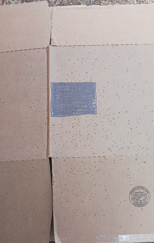

Check to see if it's regulated, Greg. Pattern it with the load you intend to carry in it, in the truck, to see if it puts both patterns on the POA. That's the definitive test for inexpensive (or expensive) S X S guns.
Looks good, but the proof is in the pudding (patterning).

I agree, I always check POI, you never know until you do. I had a Grulla that had a POI that was 1' Left and 2' Low at 16 yds on one bbl and 2' high on the other. Had Briley tube it and all was well.
You must be a mind reader, I plan on doing that today. I'll give a report when it's done.

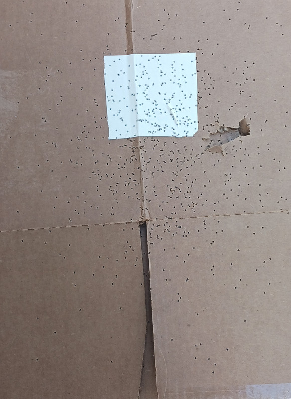

[Hey all, took the Kestrel out to see about the bbl regulation. Both bbls shot just a tad low. Not much however. Shot POI at 16 yds. 3 rounds per bbl
The right bbl is the black square
The left bbl is the white square
Stay well my friends
Greg

Go play the lottery, Greg. You're on a roll, brother.
