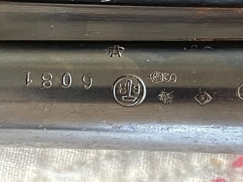

Looks like there's a stamp on the standing breech between the strikers??

Besides the Gebrüder Röchling stamps, if that other stamp is a Heart with >>EES<< in it, then that is Emil Eckoldt's trademark.

This intertwined >>TS<< closely resembles that of Thieme & Schlegelmilch / Carl Adolph Thieme and Heinrich Nicolaus Schlegelmilch. This would account for the Schlegelmilch reference.

I think I remember T&S being a principle in Romerwerke / Röhmerwerk / Jacob Römer / Röhmer Waffenteilifabrik who did a lot of heavy lifting for the mechanics in Suhl. Odd looking action.

Raimey, Please forgive my ignorance, but do you speak/read german? There is an article about the patented safety mechanism of my gun that is entirely in german.I have a copy but no translation. It references the patent date of 1891. I've been told it's all about the patent and not about the gun maker. Still it's something.
I will pull the gun out tomorrow and shoot some better pics of stamps and get an answer for you about the letters inside the heart stamp. Also a better profile of the gun. It is a field grade no doubt, but certainly well made and quite robust.

Unfortunately for now, I do not speak German, but can stumble thru texts and Old German is a task for even most Germans.
I did find that Ernst Schlegelmilch filed for patent protection in the U.S. of A. under # 356,878

Nimrod Gewehrfabrik(T&S) was a principal @ Röhmer Waffenteilifabrik, so Röhmer Waffenteilifabrik did the heavy lifting for their wares & apparently for Ernst Schlegelmilch too.

I am curious where the Reeb name is located?

Quality foto of the unique >>RRA<<, whatever stamp. I don't believe you could capture a better image, but maybe very what the letters are. Maybe a centred foto??
Yes, Emil Eckoldt in Suhl stamp. For me, this validates that Emil Eckoldt did indeed do tube work. So the >>EE<< initials on Lindner's wares do indeed note effort by Emil Eckoldt. The >>Boxed Ks<< are double stamped but I believe them to be Ks?? Therefore, choose Kelber or Klett. More correlation needs to be here on the K tube efforts. Kelber - Klett converted the rough bored tubes & Emil Eckoldt brought the tubeset to final form. Thieme & Schlegelmilch forged the frame @ Röhmer Waffenteilifabrik and then did the action work. Who knows, Emil Schlegelmilch may have worked @ T&S??
