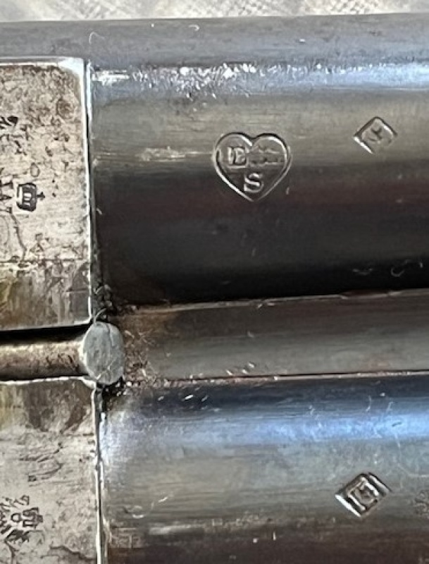

Besides the Gebrüder Röchling stamps, if that other stamp is a Heart with >>EES<< in it, then that is Emil Eckoldt's trademark.

Quality foto of the unique >>RRA<<, whatever stamp. I don't believe you could capture a better image, but maybe very what the letters are. Maybe a centred foto??
Yes, Emil Eckoldt in Suhl stamp. For me, this validates that Emil Eckoldt did indeed do tube work. So the >>EE<< initials on Lindner's wares do indeed note effort by Emil Eckoldt. The >>Boxed Ks<< are double stamped but I believe them to be Ks?? Therefore, choose Kelber or Klett. More correlation needs to be here on the K tube efforts. Kelber - Klett converted the rough bored tubes & Emil Eckoldt brought the tubeset to final form. Thieme & Schlegelmilch forged the frame @ Röhmer Waffenteilifabrik and then did the action work. Who knows, Emil Schlegelmilch may have worked @ T&S??
