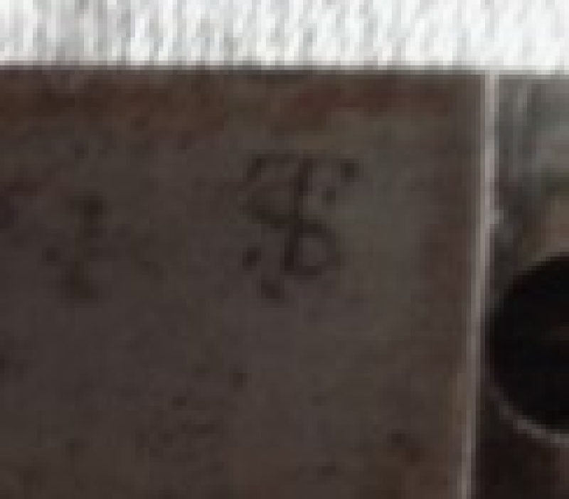

This intertwined >>TS<< closely resembles that of Thieme & Schlegelmilch / Carl Adolph Thieme and Heinrich Nicolaus Schlegelmilch. This would account for the Schlegelmilch reference.

I think I remember T&S being a principle in Romerwerke / Röhmerwerk / Jacob Römer / Röhmer Waffenteilifabrik who did a lot of heavy lifting for the mechanics in Suhl. Odd looking action.

Nimrod Gewehrfabrik(T&S) was a principal @ Röhmer Waffenteilifabrik, so Röhmer Waffenteilifabrik did the heavy lifting for their wares & apparently for Ernst Schlegelmilch too.

Yes, Emil Eckoldt in Suhl stamp. For me, this validates that Emil Eckoldt did indeed do tube work. So the >>EE<< initials on Lindner's wares do indeed note effort by Emil Eckoldt. The >>Boxed Ks<< are double stamped but I believe them to be Ks?? Therefore, choose Kelber or Klett. More correlation needs to be here on the K tube efforts. Kelber - Klett converted the rough bored tubes & Emil Eckoldt brought the tubeset to final form. Thieme & Schlegelmilch forged the frame @ Röhmer Waffenteilifabrik and then did the action work. Who knows, Emil Schlegelmilch may have worked @ T&S??
