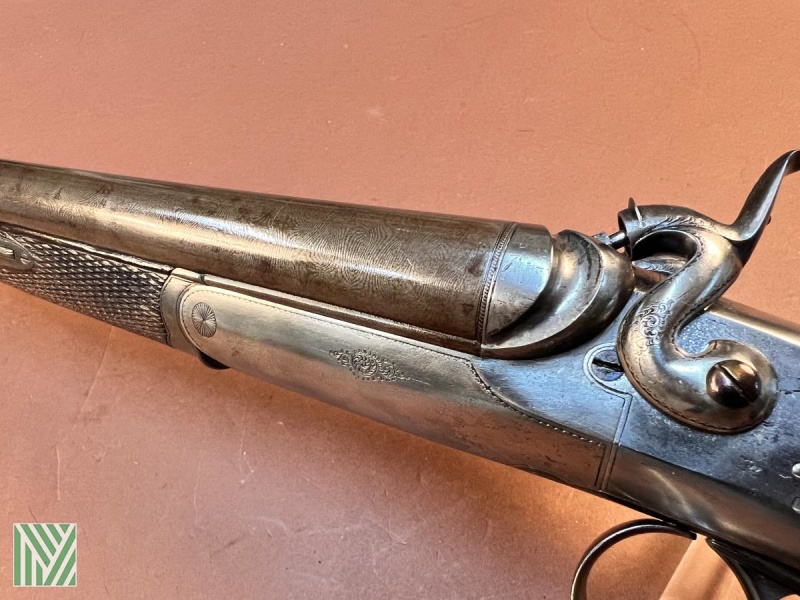

Originally Posted By: Joe Wood
Ken, mine is a 12 gauge weighing 6 pounds 12 ounces. It is early, having the wedge fastener on the forend. Butt section of barrels also appear to me to be laminated, joined to more of a stub pattern forward.
The serial number on the buttplate is stamped on the outside. Buttplate, triggerplate, and triggerguard carry factory nickel plating.
Makes sense. The butt section looks like this:
Regards
Ken

Schilling ? From July 19, 1883 and repeated from 1882 that Daly does not use Schilling products.

Raimey: that gun has some sort of large scroll Damas Crolle
The old thread re: Cluny has lost the images.
Early SD&G catalogs listed the Lindner Dalys as having Cluny, Bernard, Turkish First Quality and Chine (Ferlacher Chine was also Turkish)
Cluny is in France north of Lyon and not far from Geneva - more famous for Burgundy & Benedictines than gun making.
There is also a Cluny Castle in Aberdeenshire. Cluny means "from the meadow" in Gaelic and is an old Irish boy's name
Unfortunately I've never found documentation of a "Cluny" pattern...but some day the Damascus Pattern Rosetta Stone will be unearthed! smile

Too, I cannot say that they are Belgian sourced, possibly England? Depends on where Scott was sourcing their tubes?

A messy 2 Iron brother, and Ferlach made lots of damascus barrels
Is that 'MV' on the L barrel? Likely the tube maker.
