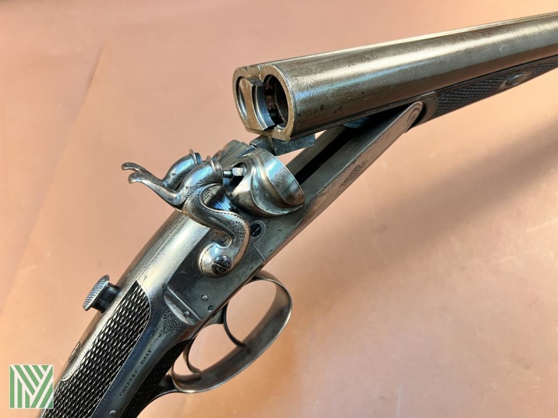

Daly Nr. 4???
Marc made a nice find on this Charles Daly on the Ferriss Patent that sold on E-Gun.
Lindner wasn't involved as he didn't have his Gunmaking Sheepskin just yet. Also, the tubeset has the initials >>PB<< & was part of a Scott Gesteck/Partskit....
