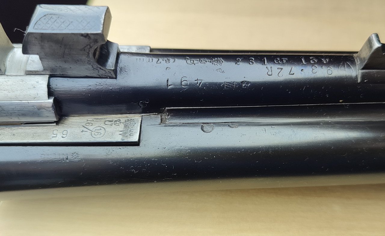

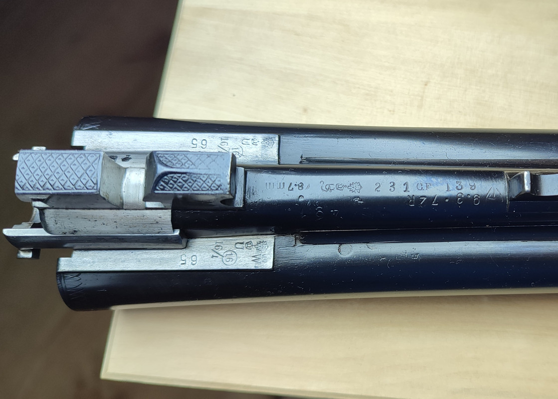

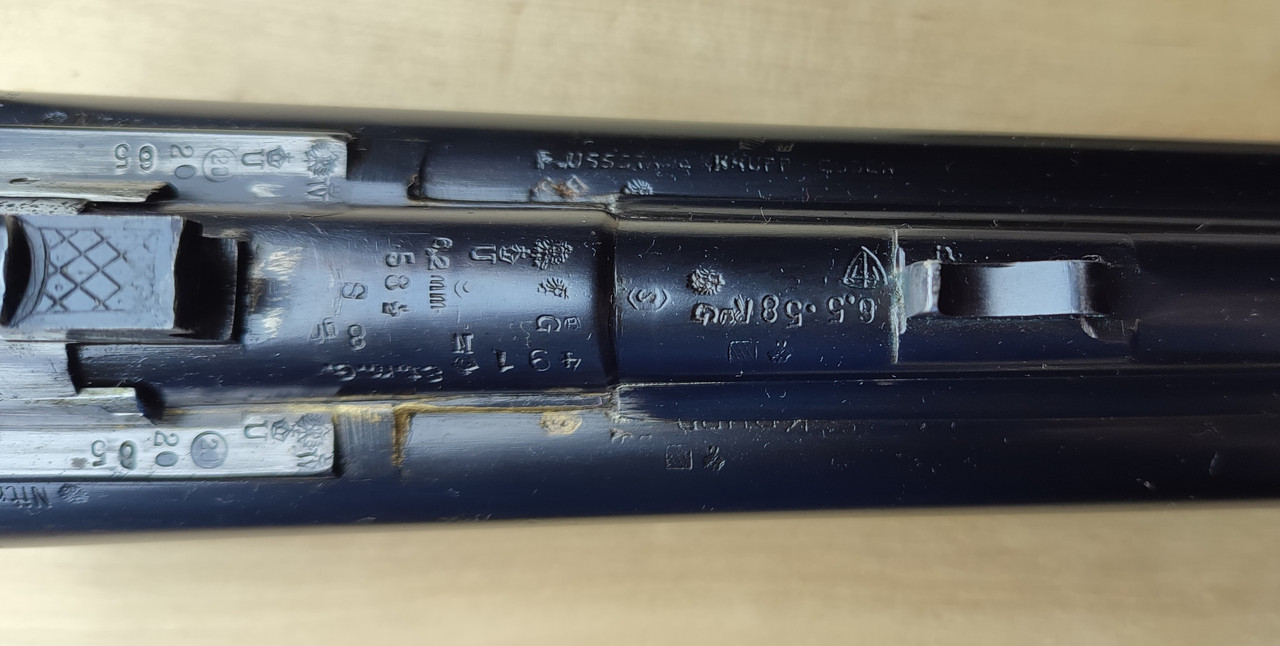

Can you help me please with identification this sidelever Hahndrilling? It is made in caliber 16/65 - 9,3 x 72R and 20/65 - 6,5 x 58R. There are names of the gunmakers on the top bars: Andreas August Ahl - Bonn and Eduard Kettner Köln. On the action is the mark [b]C.F.. This mark is also on the bottom of the barrel. I think it might be a brand of Christoph Funk. But what about the other marks on the barrels - circled in red in the pictures? [img]https://imgur.com/CrWFsJX[/img][img]https://imgur.com/svvghE8[/img][img]https://imgur.com/Zxcilzj[/img][img]https://imgur.com/bkWfWlY[/img][img]https://imgur.com/vKxrjBF[/img][img]https://imgur.com/D2jfYkV[/img]

The mark of the >>S<< in a Chevron denotes tube work by the Schilling Forge.
Also present is the post WWII mark(Reproof) of the München Proof Facility. There's also the repair mark on the water-table.

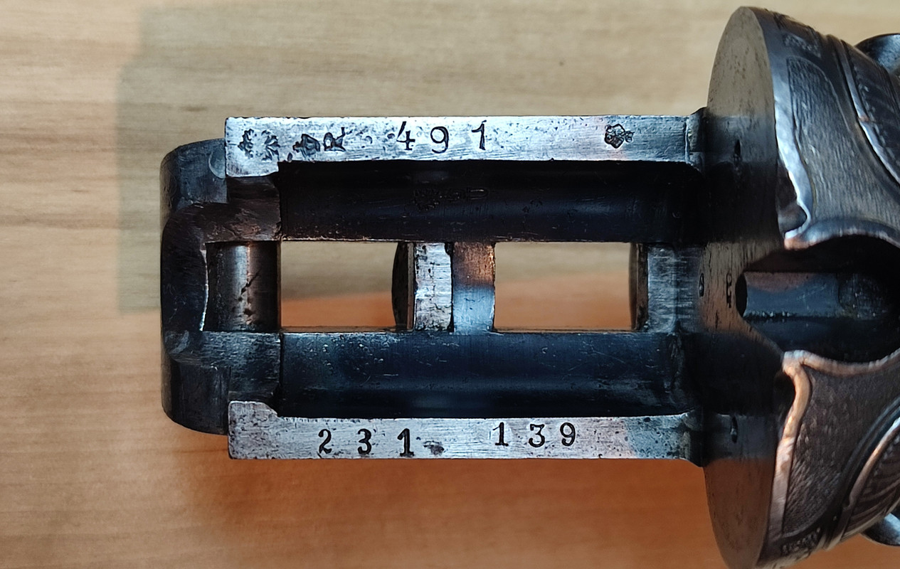

Thank you very much for your answer. Here are some additional photos: The Action: [Linked Image from i.postimg.cc], barrel set from Andreas August Ahl Bonn am Rhein: [Linked Image from i.postimg.cc], [Linked Image from i.postimg.cc] and barrel set from Eduard Kettner: [Linked Image from i.postimg.cc] .Sorry for the quality of the photos, I didn't have much time. Do you think the numbers 131, 239, 491 are proof dates? This drilling seems older than 1931...

No, those are serial numbers associated with the Suhl mechanic that pushed the longarm thru the Suhl Proof facility. Another slight possibility is that one is that of the additional maker; another of Ahl and another of Kettner??

I for sure can see a Nitro stamp on the side of the 20 bore platform. I think I see a Nitro stamp on the side of the 16 bore platform. So it was made in Suhl between 1912 & 1914/1915. Then there were some alterations or improvements that warranted the additional proof efforts.

Yes I see the stamp of Eagle Nitro on the side of the 16 bore platform so I hold with the above.
