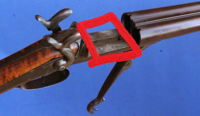

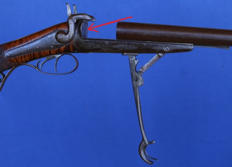

what is water table and standing breach?
Posts: 12,689
Likes: 514
Posts: 12,689
Likes: 514
Water-Table on Pinfire lifted from here:
https://doublegunshop.com/forums/ubbthreads.php?ubb=showflat&Number=574708&page=3
Standing Breech
