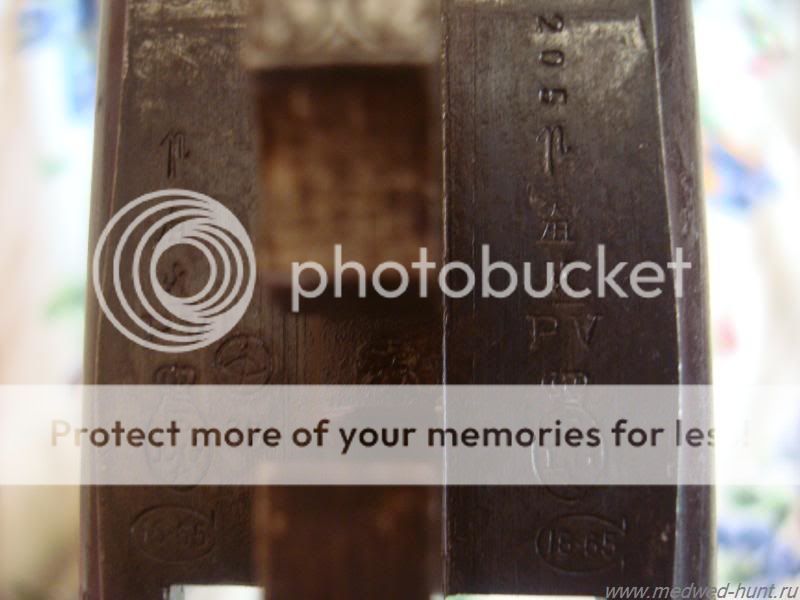

Interesting mix of proofmarks above, Raimey. Some are clearly Belgian, but some Belgian marks missing, and others not Belgian. Another of those mysteries.
Posts: 12,849
Posts: 12,849
Jeff:
Marc only had stored the images and Mr. Hallquist may know the origin of the double.
Mr. Brown:
Truly a mystery and I'm guessing some sort marks from Bulgaria/Romania/Yugo. etc. And as I stated before, still searching.
The Belgian proofs are post 1924. The date code (1927) does not match the controller of proof for dating (1937-1964). I agree with Larry, many marks are missing....
Some of those other marks appear rather amateurish.
Gaier talks about stock carving, but the only Belgian guns I have seen with it were for export or are high end guns in museums. This one is much nicer than those cheap export klunkers. Checkpiece, sling swivels, 65mm 16ga, it was certainly meant for the European market.

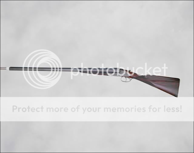

The photo is a Faukner, Prague, SLE 12. I've also seen a fine 16 by Faukner which is a box lock with small side plates in the form of a crown. The image above reminded me of that gun.
Posts: 12,849
Posts: 12,849
Terry:
Do you own the example? I really like stock with the subtle cheekpiece.
