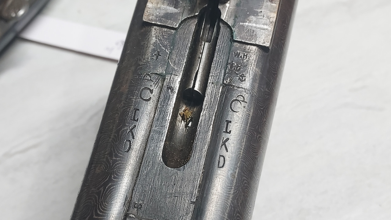

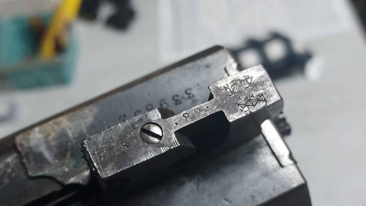

I have an 1894 barrel that has been re-choked and has the marked shot count on the lug X-ed out. I would like to compare the XX stamps with the OP's. The choke mods are a bit weird as it is the left barrel that was opened up.

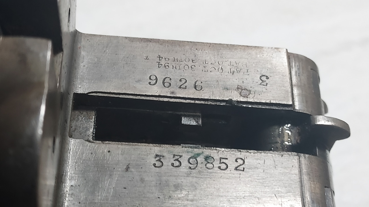

Semmer called that extra four-digit number on the left watertable and forearm iron (circled in red) an assembly number --
Not sure I buy that as the serial number (yellow) or the last three or four digits of it are stamped on most every part of the gun. I don't believe anyone still alive knows what that four-digit number really means. We don't see that extra four-digit number on A- to EEO-grades?!?
In going through the pictures I've saved I found a 16-gauge with the pellet counts on the lug Xd and Hd out.
We see the W.H. on a lot of Remington doubles and the anchor inspector's stamp is seen on most Remington guns throughout their history.
