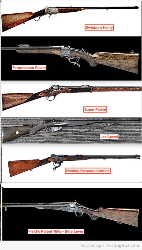

**571872-1912 Reilly sells other Military/Sporting Rifles: Swinburn, Gibbs, Westley Richards, Soper, Field's Partent, Lee-Speed ![[Linked Image from jpgbox.com]](https://www.jpgbox.com/jpg/76017_452x768.jpg)
The Snider-Enfield was apparently the last military rifle Reilly made in his London workshops and consistently serial numbered. He did not serial number the Reilly-Comblain nor the Martini-Henry sporting guns he sold. However, he continued to advertise and market military rifles, selling some to the Volunteer Militia and some to private owners for sport. Some of these were indeed finished in his workshops and a couple have serial numbers which were made after the expiration of the applicable patents; Some were made elsewhere and only marketed. Here are six:
Swinburn-Henry: **57a The Swinburn was similar to the Martini-Henry but differed internally quite a bit. For instance it had a thumb manipulated side lever which could cock the hammer without operating the lever. It fired the same .577/540 Martini-Henry cartridge but was more prone to breakage. It was patented in 1872 and all production was done by by Abingdon Works Co. Ltd., Birmingham. Reilly’s first advertisement for a Swinburn rifle (which he misspelled) is from October 1875.
*57a1 . . . . . . . . . .-- There is one extant Reilly Swinburn from about 1885 in the Royal Armouries. It is highly engraved with a lion surrounded by fine scrollwork on the right side of the receiver and two stags on the left. It is engraved “E.M. REILLY & Co., 277 OXFORD STREET, LONDON, AMMUNITION GOV 577.450.”
*57a2 . . . . . . . . . .-- A second extant Reilly Swinburn was auctioned by Holts in 2025: *57a3
George Gibbs “Farquharson Patent”: *57b This is a single-shot hammerless falling-block action rifle. It was patented by John Farquharson in Scotland in 1872. George Gibbs, a Bristol gun-maker, bought into the patent in 1875 and was the sole maker until the patent expired in 1886. Per Wikipedia, fewer that 1,000 Gibbs-Farquharson rifles were made, the last in 1910. Famous hunter Frederick Selous was known to use the rifle.
*57b1 . . . . . . . . . .-- There is one extant Gibbs-Farquharson .451 cal rifle with Reilly's name on it, signed “E.M. REILLY & CO., 277 OXFORD STREET, LONDON,” with a Gibbs serial number 1331 (Wikipedia can be wrong too).
*57b2 . . . . .
Westley-Richards 1868 .451 breech-loading carbine:*57c In 1868 Westley-Richards patented a breech loading action for the .451 high velocity cartridge. It was entered in the 1868 trials but ultimately lost out to the Martini action coupled with a Hentry barrel. However it was marketed successfully in South Africa where it continued to be used and improved upon for many years. In the modern market-place it is usually identified as an "Improved-Martini" although its action has little to do with the Martini action.
. . . . . . . . . .-- At least one Reilly marketed WR patent carbine exists with a Henry barrel with the address “E.M. REILLY & CO., NEW OXFORD STREET, LONDON.”
The Soper Rifle: *57d The Soper Birmingham-made breech-loader missed out on the breech-loading trials in 1867-68. However, in a separate test in 1872 it fired 60 rounds in one minute, a rate not matched by magazine guns. Soper put up a £100 bet ($10,000+) in 1878 that he would match two men firing his gun against three firing any other rifle in the world to see who could get most rounds on a 200 yard target in 3 minutes. No one took him up on it. Per an early 1880 advertisement Reilly was the Soper rifle "agent for London."
*57d1 . Examples of the Soper rifle in 1870 and 1880 are pictured.
*57d2, 57d3 . . . .
Field's Patent: *57e The Field’s Patent rifle is a falling block single-barrel rifle patented by William Field in 1877 while working for Westley-Richards. It was used extensively by notable London gun makers including in particular Holland & Holland to make elegant, robust big-bore hunting and sporting rifles. It often employed a side-lever design eliminating the under-stock cocking lever and giving it a sleek look.
. . . . . . . . . .-- There is one extant Reilly Field’s Patent Rifle SN
32755 (1891), “E.M REILLY & CO, 16 NEW OXFORD STREET, LONDON on the barrel rib. It is a .500 BPE side lever design manufactured after the expiration of the patent.
Lee-Speed: *57f The Lee-Speed was a bolt-action magazine rifle, which was basically a sporting variant of the Lee-Enfield made for civilians. The first advertisement for a Reilly marketed Lee-Speed appeared in 1893.
*57f1 A number of London gun-makers offered Lee-Speeds for sale to sportsmen including Holland & Holland.
*57f2 . . . . . . . . . .-- There is one extant Reilly marketed Lee-Speed shooting the .375 x 2.5” nitro express cartridge, introduced in 1899 (basically a hunting cartridge, a slightly longer version of the .303 necked out to .375). This Reilly has on the barrel “E.M. REILLY & CO., 295 OXFORD STREET, LONDON” indicating it was marketed between May 1904 and June 1912.
