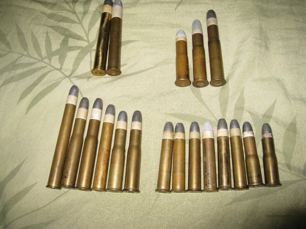

Originally Posted by BrentD
18 hrs later, the photos of the Sharps cartridges didn't make it through. Lets try again.
I don't know what is so difficult about posting a photo on this forum that it would take over 18 hours.
It took me less than a minute to find and save this photo of various Sharps Paper Patched cartridges, and then about another 15 seconds to attach it to this post. Easy-Peasy... a Caveman could do it!
