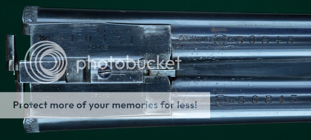

vam5067 #600608 07/31/21 08:36 AM
Posts: 12,841
Posts: 12,841
[Linked Image from i697.photobucket.com]
G. Defourny-Sevrin
Obsequio del Real Club de Espa�a de Torreon
Campeonato Tiro Pichon Torreon
Fluid Pressed Steel Whitworth's(Trademark not present as I see?)
but a tubeset by T. Kilby Special Fine Steel, wearing Birmingham touchmarks, sourced by Springer in 1934, or something on-hand used by Springer.
T Kilby Tubeset Nr. 30845 - NOT WHITWORTH?
A thread with the typical seen Whitworth tubes then others like the above, with Krupp tubesets by Kilby in the mix. Anyone have interest?
