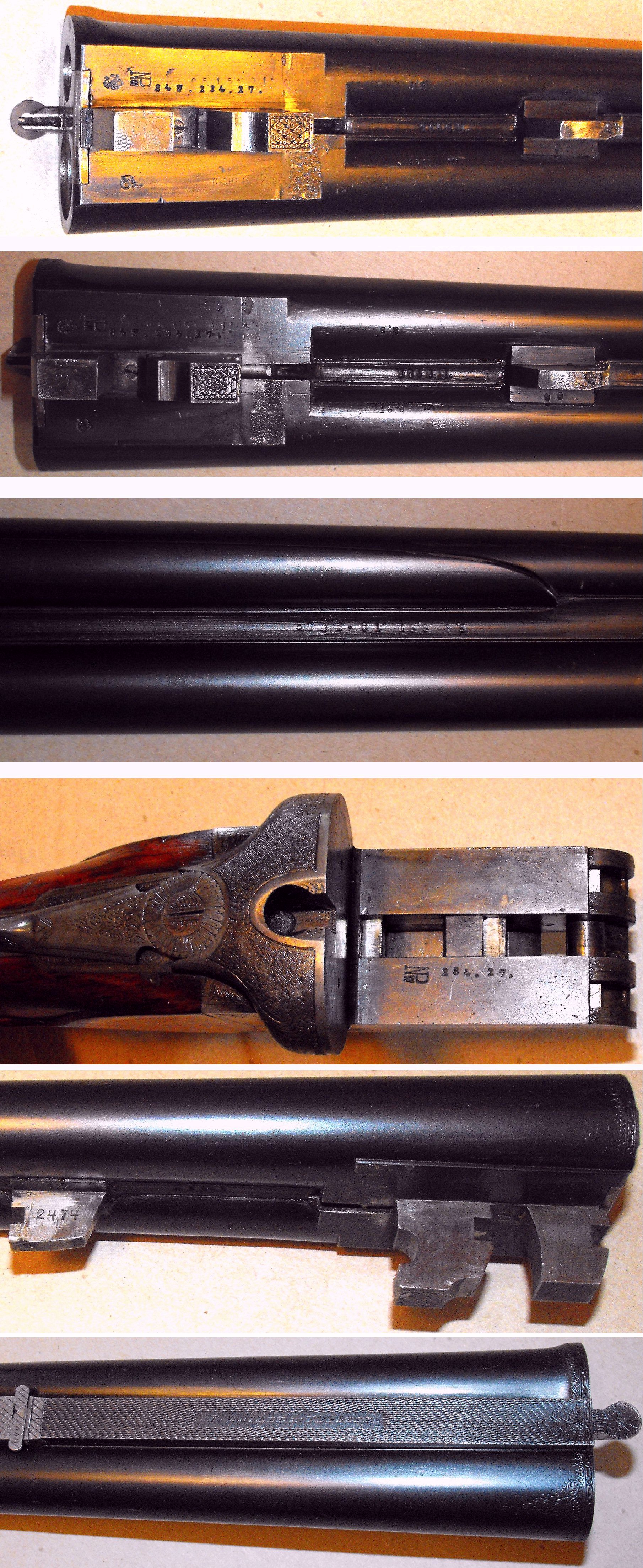

The 1st pass thru the Weipert proof facility was in 1901 followed by what looks to be a re-work in 1927, with a subsequent pass thru the Weipert proof facility. The tubeset weighed 1648 grammes. This example may also support the theory that the Bohemian Rampant Lion was used in 1927 per the stamp below the Weipert Nitro stamp. Many of the older marks were worked off..... But a better image of the stamps forward of the flats might net some info.
It is an Anson & Deeley Body Action and I would assume made by Gustav Bittner, although I don't see any marks right off but I am the custodian of a couple similar examples bearing his name.

I would say that Franz Thiele of Teplitz-Schönau(CZ) was purely a firearms merchant.

Too, I am sure the ledger entries of the Weipert Proof Facility are still in existence & some information lies therein. I seem to remember them to be on their historical website but I do not believe the respond well to an inquiry in English?

I thank you for the information. I have attached a photo showing all the markings I could find on this gun.
Is it possible that this gun started life as a double barrel shotgun in 1901, and was later converted to a Cape Gun in 1927?
