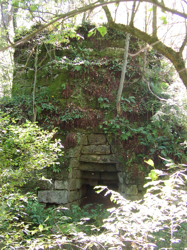

Then, a couple years ago, I decided to revisit some old deer hunting spots because the places I was hunting were becoming unproductive. I remembered that I had killed my first buck with a flintlock off the top of an old stone furnace I literally stumbled into in the early morning darkness. I managed to climb on top of the 30 foot high ruins, and shot my buck later that morning. When I told a friend who hunted there in the past, he informed me that the furnace was an old brick oven, according to locals. Here's a pic of Webster Furnace where I shot my first buck with a flintlock.
As I looked at this area again to see if I could determine whether it was still open to hunting, I learned that the furnace was actually an old cut stone cold blast furnace that was built in 1837-38. The water wheel that drove the bellows, and the wooden casting shed, and all other buildings and structures were long gone. These furnaces typically ran until all the wood for miles around was cut down and consumed after being converted to charcoal. Trying to learn the history of this furnace led me down a long rathole of the history of early iron making in my state, and the U.S. Then I looked back earlier to Europe, India, and other places where iron ore was smelted. I also learned that much of the early terminology has carried over to the present day, and that the basic chemistry is much the same as when steel was first produced in very small quantities and was more valuable than gold.
This took me down the path of learning much more about cold blast furnaces, early hot blast furnaces, and many of the various processes and furnaces for conversion of iron to steel, including the Bessemer Process. Cursory study will show that trying to lump all Bessemer and Bessemer Process steels into one neat little box is just silly. The range of characteristics and quality is huge. A couple samples sent to a met lab will not tell the story. Ten thousand samples might be a good place to start.
I'm not going to copy-and-paste all of that here though, to try to prop myself up as some expert. As much as I've learned and seen and experienced, I am nowhere near an expert, and neither are you... not even close. And I could tell you that if you can't take a little criticism, you wouldn't last two days in a mill where they make steel.
