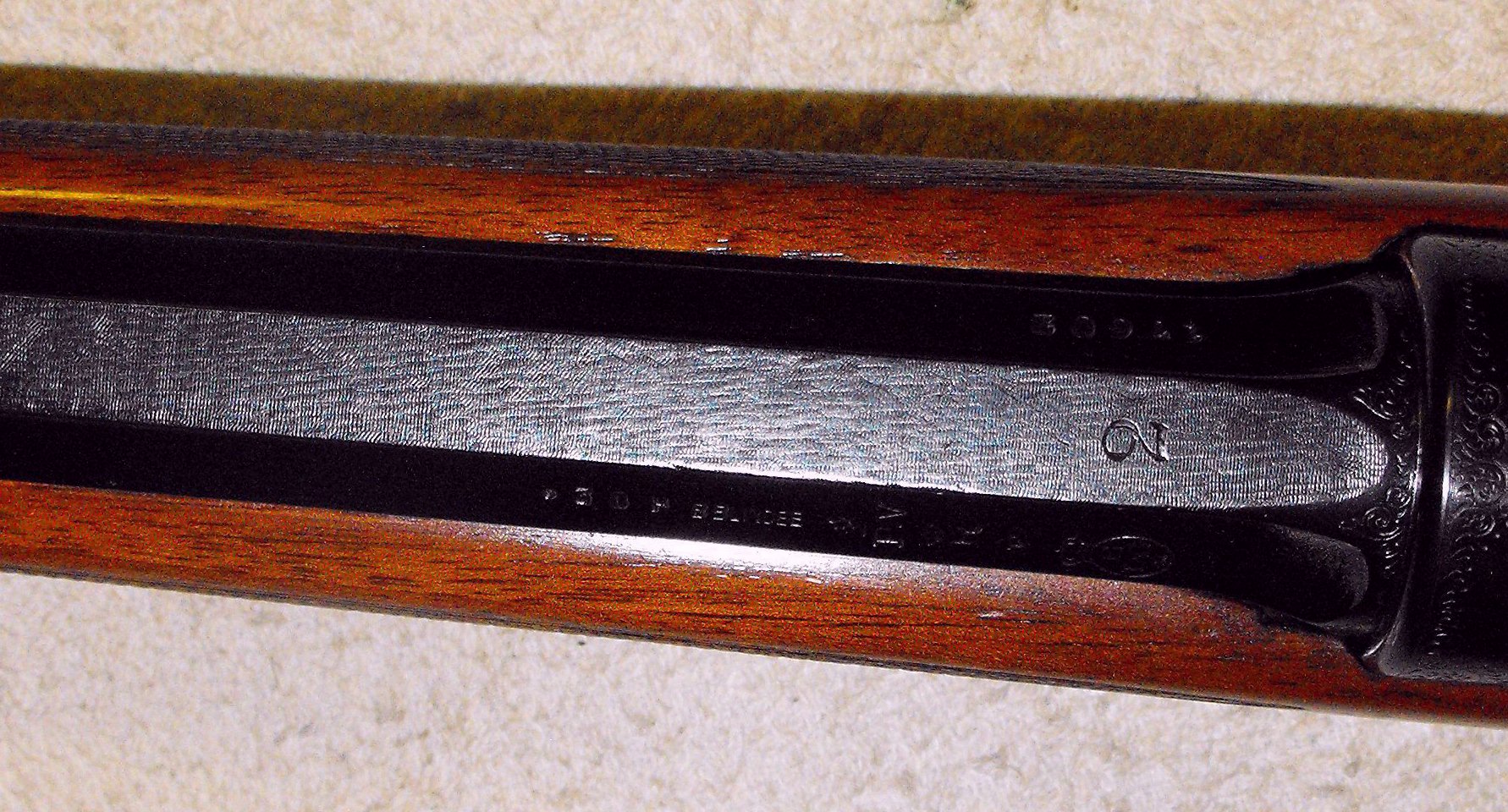

left barrel flat is stamped "POLDI-ANTICORRO" .... and .... BEMESU (Bernard Merkel trademark) .... and .... "7 x 64" .... and "GERMANY"
left top angle flat is stamped ".30 H" ... (chamber cast shows 300 H&H caliber) and ... BBUNDEE ... and ... various Belgium Proofs.
left side of action forward ring has Belgium Proofs.
raised 1/4 rib has a large "2" engraved just forward of the receiver ... 1/4 raised rib has no rear sight. ...
there is a low full rib along the complete length of barrel transitioning into a front ramp. rib is matted full length.

The 7x64 is not a typo ... that was the original caliber that this gun was intended to be, a 7x64 Breneke.
According to another source in Germany;
".... As the Belgian proofmarks show, the conversion to .300 H&H was done by or for Mahillon. The .30H caliber designation is part of the Belgian, Liege, proofmarks: B(alle) BLINDEE = jacketed bullet, PV = smokeless powder, crown/R = rifled barrel, star or crown/E(?) = inspector's mark, ELG = Liege proofhouse acceptance. I think the stock was made by Hoffmann Arms, reusing the German hardware, as the stock shape is neither German nor Belgian.
Poldi Anticorro was a high grade (read: expensive) rust resistant barrel steel by the Poldi steelworks in Kladno, Bohemia. .... IMHO the rifle was originally made by Berhard Merkel as a 7x64 during the interwar years, soon converted by Mahillon and restocked by Hoffmann Arms in the 1930s. As such German barrels usually had an integral full length rib with a rear sight, the rib was likely milled down to the quarter rib shape by Hoffmann (Mr.Howe?), removing the rear sight dovetail. ..."

The rear part of the(milled down)rib is so poorly matted , that I canīt imagine as the work of so qualified smiths like Hoffmann/Howe or Mahillon .

As far as the rib matting goes, my picture taking skills are lacking. The camera's flash is the problem. The matting is in fact very well executed with a "super-fine" matting to reduce glare and it appears to be done by hand.
